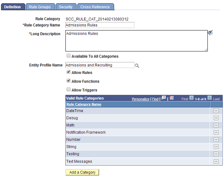

Access the Rule Category Definition page (Set up SACR, and then System Administration, and then Rules Engine, and then Setup, and then Define Categories, and then Definition).
This example illustrates the fields and controls on the Rule Category Definition page. You can find definitions for the fields and controls later on this page.
Using this category as an example, you cannot create Functions or Rules in category Math, but you can create Functions and Rules in category AIR Functions and CALL Functions in category Math.
Field or Control Description
Rule Category
Displays a unique ID generated by the system. When adding a new Rule Category, the default value is NOID. After saving the Rule Category, a unique ID is generated by the system and assigned to the Rule Category. The ID is created by combining prefix “SCC_RULE_CAT_” with the system date and time stamp in format YYYYMMDDHHMMSS.
Rule Category Name
Enter a Rule Category Name. The Rule Category Name is used when searching for a Rule Category and for display.
Long Description
Enter descriptive text explaining the function of the Rule Category.
Available to All Categories
Select this check box to make this Category automatically available as a valid Category in other Categories. Categories that are defined as “Available to all Categories” cannot have any Valid Categories of its own. When this check box is deselected, the Category is no longer available in other Categories.
Note: Security settings on the Rule Category affect all Rules, Functions and Triggers which have been called from or created in this Category.
In the example below the Category Math has been made available to Category “Admissions Rules” as a Valid Rule Category. Every Function and Rule Created in Category Math can now be called from a Function or Rule created in Category “Admissions Rules”.
Note: Deselecting “Available to All Categories” on category Math would remove the Category from Admissions Rules and invalidate the security on the Call statement of rules which have already been created. Although this would not break compiled Rules it would cause problems when users want to change those rules.
Entity Profile Name
Enter the Entity Profile Name that you want to associate to this Rule Category. Rules, Functions and Triggers can be built using the Base Entities which have been setup in this Entity Profile. If the Entity Profiles uses Views, access to certain properties within an Entity may have been restricted.
Allow Rules
Select this check box to allow the creation of Rules with this Rule Category.
Allow Functions
Select this check box to allow the creation of Functions with this Rule Category.
Allow Triggers
Select this check box to allow the creation of Triggers with this Rule Category.
Valid Rule Categories
Select Rule Categories available to this Rule Category. The Rules, Functions, and Triggers of the selected categories can be called by Rules created in the main Category.
Note: This is not an inheritance model. Adding a valid Rule Category here gives you access to the Rules, Functions, and Triggers native to that Rule Category but not to Rules, Functions, and Triggers of any Rule Categories associated with the selected Rule Category.
Access the Rule Category Rule Groups page (Set up SACR, and then System Administration, and then Rules Engine, and then Setup, and then Define Categories, and then Rule Groups).
Use this page to add valid Rule Groups to this Rule Category or to restrict users to only being able to build Rules by using one of the associated Rule Groups.

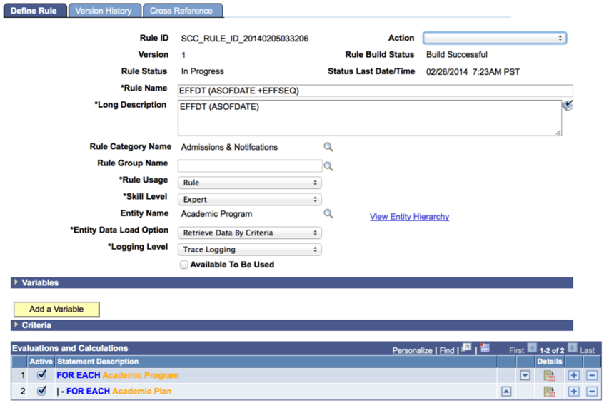

Example of an LOV Added to a Property from Record Field Prompts
The following is an example of an Entity Registry LOV which has been added to the Property due to the fact that the underlying Record field was defined with a prompt table value. In this Rule, the Entity Academic Program is used to retrieve applicants.
This example illustrates the Define Rule page using a LOV from Field Record Prompts.
Example of Define Rule Page Using a LOV from Field Record Prompts

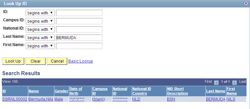

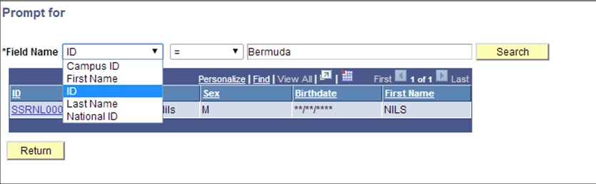

In this example in the Criteria grid, the Type of the Property with theLabel of EmplID is set to Text. Click the Search prompt button to the right of the Object (value) for Property EMPLID to open a Lookup table. This is the PEOPLE_SRCH Prompt for table. This functionality also works whenever a Property with a Lookup table is used in combination with the Assign or IF Evaluative statements. The same Search values are available and, if relevant, permission level security is enforced:
This example illustrates the Prompt Window for Example Of Define Rule Page Using A LOV From Field Record Prompts.
The Search function behaves the same as if prompted from a normal search record or component:

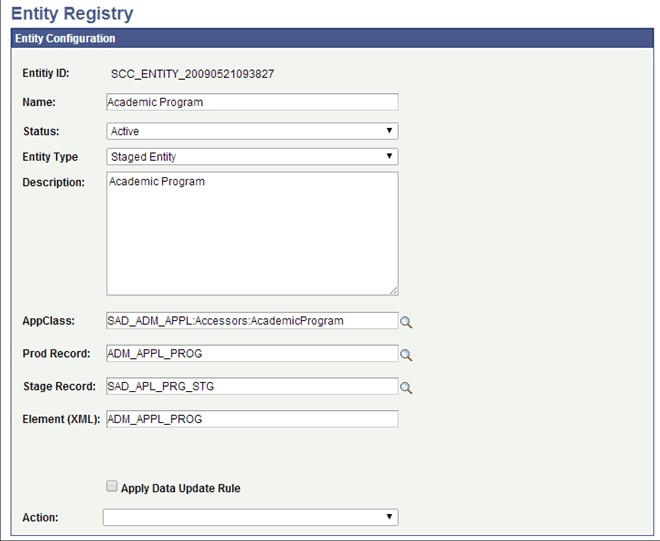

The Lookup functionality for EmplID Property is enabled by the Entity Registry. To view the Entity Prompts, access the Entity Registry page (Set Up SACR, and then System Administration, and then Entity, and then Entity Registry).
This example illustrates the Entity Registry Window for Example of Define Rule Page Using a LOV from Field Record Prompts

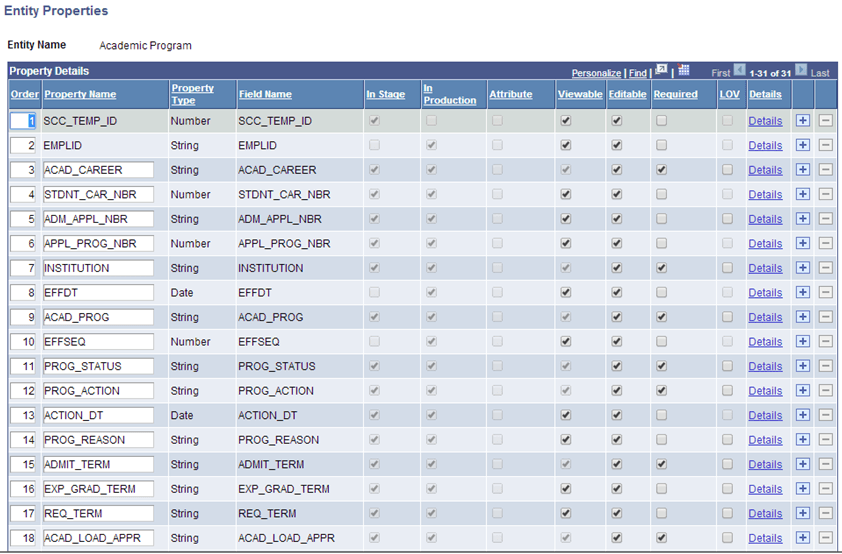

Select Edit Properties from the Action drop-down to view the Entity properties:
This example illustrates Entity Properties Window for Example Of Define Rule Page Using a LOV from Field Record Prompts.
Entity Properties Window for Example of Define Rule Page Using a LOV from Field Record Prompts

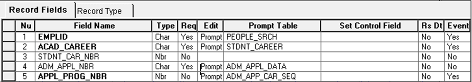

Prompt values present in a production record or staging record of an Entity are added to the Entity Registry automatically. Any Property which has inherited a Prompt from a production or staging record is displayed as view-only in the LOV column of the Entity Properties page. In this example the field EMPLID has inherited a prompt to the PEOPLE_SRCH table from the ADM_APPL_PROG production record:
This illustrates the Property and Prompt Table for Example of Define Rule Page Using a LOV from Field Record Prompts

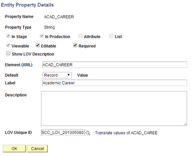

For an example of a LOV Look Up Table that is NOT present on the production or staging record and has been added to an Entity Property, select the Details link for property ACAD_CAREER in the Entity Properties page example. This opens the Entity Properties Detail page where an LOV Lookup Table can be added using the LOV Unique ID field for a relevant LOV:
This illustrates the Entity Property Details Window for Example of Define Rule Page Using a LOV from Field Record Prompts.
Entity Property Details Window for Example of Define Rule Page Using a LOV From Field Record Prompts
