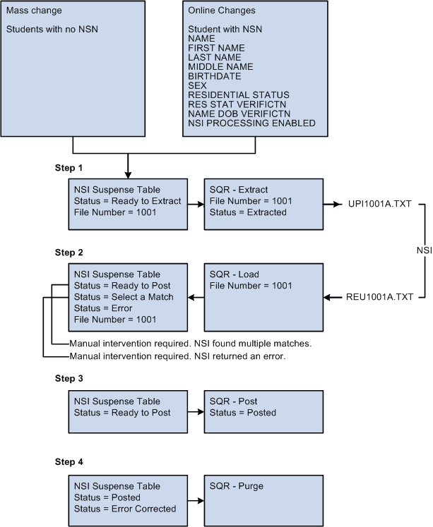

This diagram provides an overview of the flow of the NSI processes. It shows the cause and effect of the status of a change in the NSI Suspense Table and the appropriate SQR action.
Overview of PeopleSoft NSI business processdiagramsNSI business process
Overview of PeopleSoft NSI (National Student Index) business process
