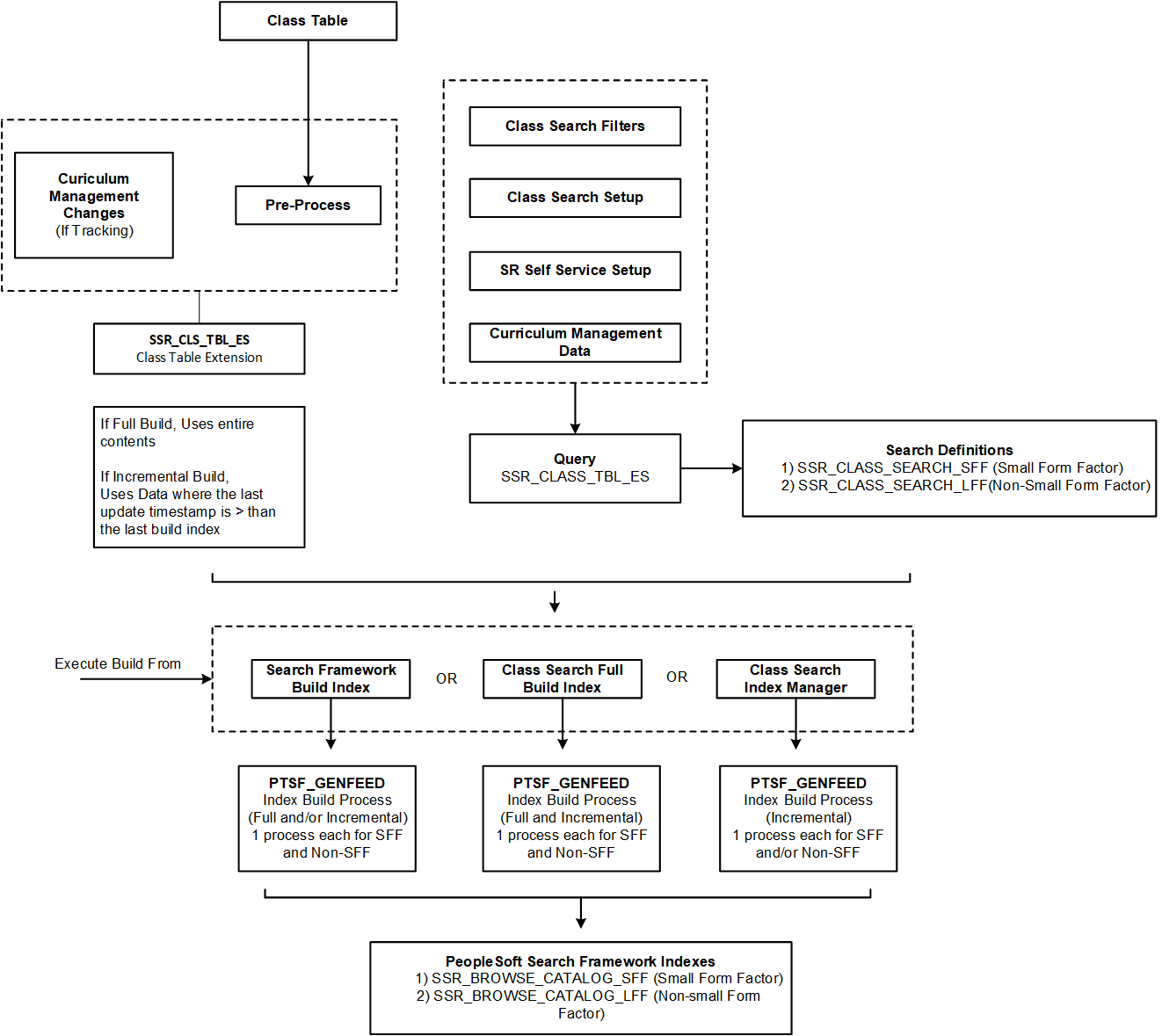

This diagram is an overview of the administrative processes required to build class search indexes
Overview of Class Search and Search Engine Administrative Process

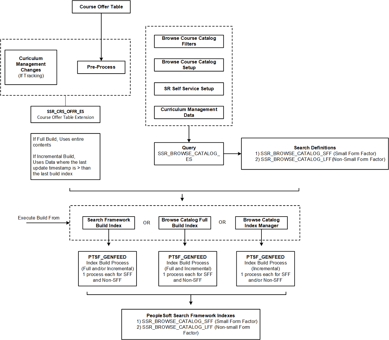

This diagram is an overview of the administrative processes required to build course search indexes
Overview of Course Search and Search Engine Administrative Process

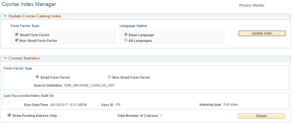

Course Index Manager
SSR_BC_IDX_TERM_FL
Curriculum Management, and then Fluid Browse Course Catalog, and then Course Index Manager
Run an incremental build.

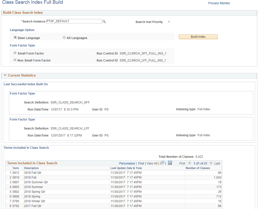

Running a Full Build for Class Search Index
Access the Class Search Index Full Build page (Curriculum Management, and then Fluid Class Search, and then Class Search Index Full Build).
This example illustrates the fields and controls on the Class Search Index Full Build page. You can find definitions for the fields and controls later on this page.
Field or Control Description
Search Instance
Select the search instance you want to use. The run control IDs for the form factor types automatically update to correspond to the search instance you select.
The full build process should be run after the initial implementation of the search engine, PeopleSoft Search Framework search definitions, and setting up class search for fluid. The process runs for both small and non-small form factor devices. It indicates the terms and number of classes that have had indexes built.
WARNING:
Running the full index build process prevents self-service class search from displaying search results as all the indexes are rebuilt. Exercise extreme care when running this process. Make sure you run this process only during system downtime or when students do not have access to Class Search.
Oracle recommends that a select few users should have access to this process.
You must run a full build if you make any changes (like adding or removing facets) to PeopleSoft Search Framework. The Class Search Index Full Build page allows you to submit a full build for small and large form factor devices. Alternatively, you can also submit a full build using the Schedule Search Index (PeopleTools, and then Search Framework, and then Administration, and then Schedule Search Index).
If you do not want to run a full build, add or remove delivered facets using the Search Category page. See Configuring PeopleSoft Search Framework for Search in Fluid.

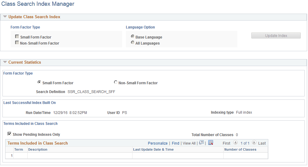

Running an Incremental Build for Class Search Index
Access the Class Search Index Manager page (Curriculum Management, and then Fluid Class Search, and then Class Search Index Manager).
This example illustrates the fields and controls on the Class Search Index Manager. You can find definitions for the fields and controls later on this page.
Use the Class Search Index Manager page to manually trigger an incremental build. The process indicates which class changes are to be made. This page displays pending classes that require an incremental build, and allows the submission of an incremental build process. The incremental build process does not prevent class search results from being displayed as not every index is rebuilt.

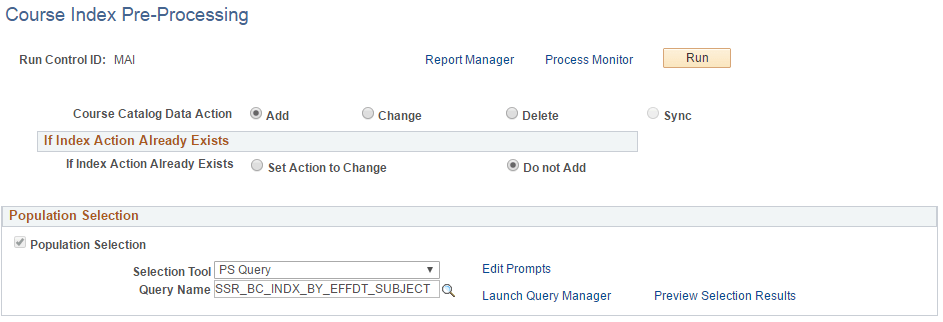

Running Course Search Index Pre-Processing
Access the Course Index Pre-Processing page (Curriculum Management, and then Fluid Browse Course Catalog, and then Course Index Pre-Processing).
This example illustrates the fields and controls on the Course Index Pre-Processing page. You can find definitions for the fields and controls later on this page.
Course Index Pre-Processinge page
Use this page to determine which courses appear in the course catalog. Initially, you run this process to make courses available for search in the course catalog. You can also use this page for ongoing maintenance.
Add
Select to add new courses to the index.
Example: Adding course for new subject
Delete
Select to remove courses from the index.
Example: Removing courses from a subject that is no longer offered
Change
Select to update courses already indexed.
Example: Adding course search filters, changes to courses typically offered, units, and so on
Sync
Select to correct courses that are not in the course table but exist in the index, and vice-versa. You can run Sync only when using the query SSR_BC_INDX_BY_EFFDT_SYNC.
Population Selection
The Population Selection group box is a standard group box that appears on run control pages when the Population Selection process is available or required for the transaction. Selection tools are available based on the selection tools that your institution selected in the setup of the Population Selection process for the application process and on your user security. Fields in the group box appear based on the selection tool that you select. The fields behave the same way from within the group box on all run control pages and application processes. If your institution uses a specific delivered selection tool to identify IDs for a specific transaction, you must use it.
Select the Population Selection check box to use the Population Selection process to select the courses that you want to be available in the course catalog search. When you select this check box, the Selection Tool and Query Name fields become available. Oracle recommends you use the delivered queries.
Selection Tool
Select PS Query.
Query Name
The following queries are provided:
  • SSR_BC_INDX_BY_EFFDT: Course Catalog Index by Effective Date
  • SSR_BC_INDX_BY_EFFDT_CAREER: Course Catalog Index by Career
  • SSR_BC_INDX_BY_EFFDT_SYNC: Course Catalog by Effective Date Sync
  • SSR_BC_INDX_BY_EFFDT_SUBJECT: Course Catalog Index By Subject

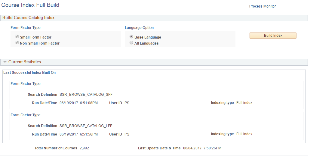

Access the Course Index Full Build page (Curriculum Management, and then Fluid Browse Course Catalog, and then Course Index Full Build).
This example illustrates the fields and controls on the Course Index Full Build page. You can find definitions for the fields and controls later on this page.
You should run the full build process after the initial implementation of the search engine, PeopleSoft Search Framework search definition, and configuring display settings for the course catalog in fluid. The process runs for both small and non-small form factor devices. It indicates the number of courses that have had indexes built.
Important:
Running the full index build process prevents the course catalog from displaying search results as all the indexes are being rebuilt. Exercise extreme care when running this process. Make sure you run this process only during system downtime or when students do not have access to course search (Browse Course Catalog).
Oracle recommends that only a select few users have access to this process.
You must run a full build if you make any changes (such as adding or removing facets) to PeopleSoft Search Framework. The Course Index Full Build page allows you to submit a full build for small and non–small form factor devices.
If you do not want to run a full build, you can add or remove delivered facets using the Search Category page. See Configuring PeopleSoft Search Framework for Search in Fluid.

Access the Course Index Manager page (Curriculum Management, and then Fluid Browse Course Catalog, and then Course Index Manager).
This example illustrates the fields and controls on the Course Index Manager page. You can find definitions for the fields and controls later on this page.
Use the Course Index Manager page to manually trigger an incremental build. The process indicates which course changes are to be made. This page displays pending courses that require an incremental build, and allows the submission of an incremental build process. The incremental build process does not prevent course search results from being displayed as not every index is rebuilt.
