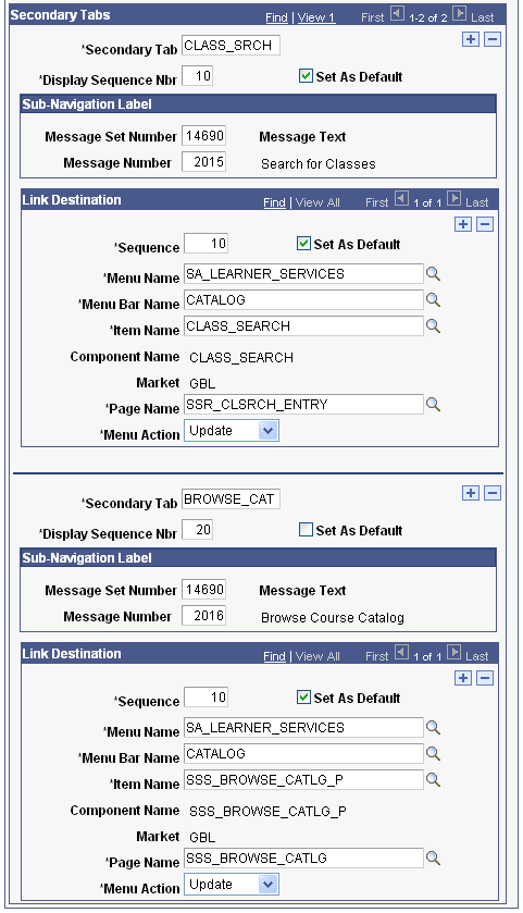

You can see how the text in the Message Text fields on the setup page correspond to the tab names in Self Service.
The Search tab has the lowest sequence number in the Main Tabs group box on the setup page and therefore appears first in Self Service. Similarly, the search for classes tab appears before the browse course catalog tab because of the sequencing of the secondary tabs on the setup page.
When students access the Search tab, the search for classes tab appears by default because the Set as Default check box is selected for that tab on the setup page.
To change the name of a tab, modify the delivered text in the Message Text field on the Message Catalog page (PeopleTools, and then Utilities, and then Administration, and then Message Catalog) or add a new message to the message catalog and associate that message with the tab.

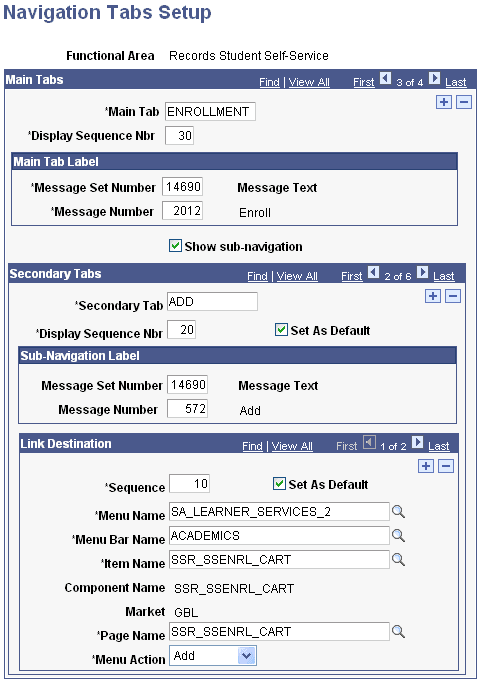

Setting up the Enrollment Tab for Student Records Self Service
You can use one of the two delivered variations of the shopping cart component under both the Plan, shopping cart tab and the Enroll, add tabs.
You can set up the add tab so that when students access that tab, they are taken to the version of the component that is used on the shopping cart tab—that is, the version with the Select check box for each class.
Here are the setup steps:
  1. On the Navigation Tabs Setup page (for Student Records), select ENROLLMENT in the Main Tab field in the Main Tabs group box.
  2. In the Secondary Tabs group box, select ADD in the Secondary Tab field.
  3. In the Link Destination group box, select SA_LEARNER_SERVICES_2 in the Menu Name field.
    Two rows exist in this group box. Ensure that you select SA_LEARNER_SERVICES_2 in both rows.
  4. Click Save.
Here is an example of the setup for the add tab using SA_LEARNER_SERVICES_2:

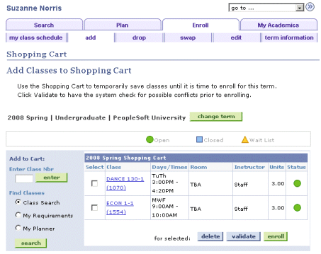

The add tab in Self Service uses the version of the component with the Select check box:
This example illustrates the fields and controls under the add tab in Student Center. You can find definitions for the fields and controls later on this page.
Example of the add tab in Student Center
If you select SA_LEARNER_SERVICES in the Link Destination group box, the Select check box does not appear on the add tab in Self Service. The check box appears only on the shopping cart tab.
