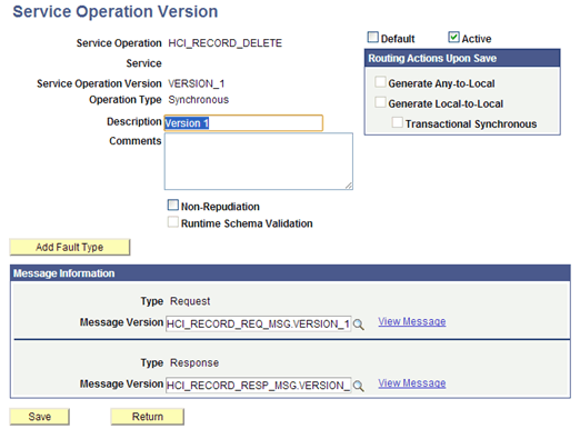

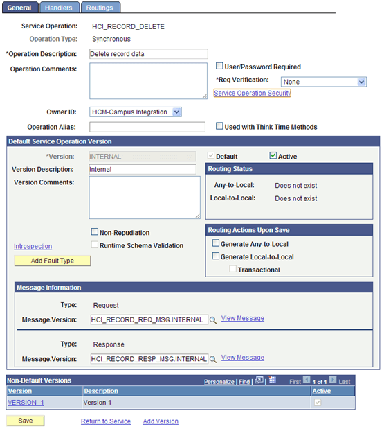

  9. Configure the HCI_RECORD service operations (optional, only if using Synchronous Message resolution method).

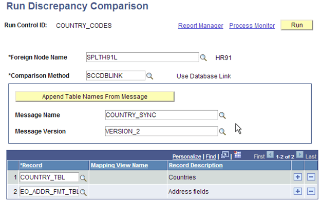

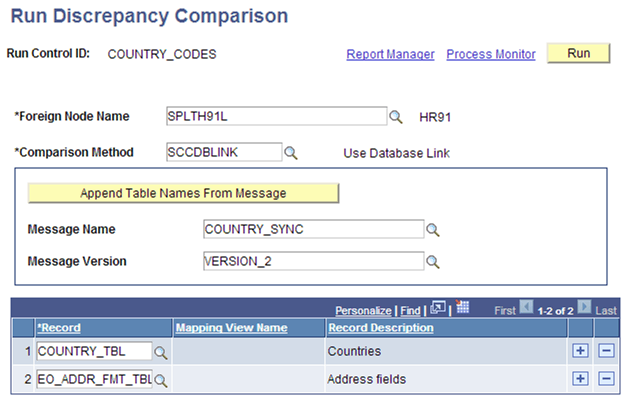

Configuring Comparison Methods
There are three delivered methods for performing data comparison:
  • SCCDBLINK—Use Database Link.
  • SCCJDBC—Use Java JDBC.
  • Full Sync Method—Full Data Publish asynchronous message process
    There is no Comparison Methods setup data for the Full Sync method as it leverages the Full Data Publish message subscription process.
Access the Comparison Methods page (Set Up SACR, and then System Administration, and then Utilities, and then HCM Integration, and then Comparison Methods).
This example illustrates the fields and controls on the Comparison Methods page. You can find definitions for the fields and controls later on this page.

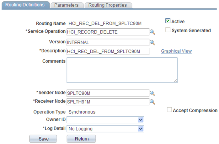

  4. Configure the routing to the Campus Solutions database, using proper transformations if required for the message being used.

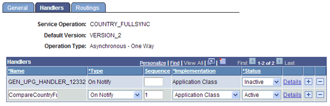

To set up service operations on the CS instance:
  1. Access PeopleTools, and then Integration Broker, and then Integration Setup, and then Service Operations.
  2. Activate the selected FULLSYNC service operation on the tables to be compared.
  3. Grant appropriate service operation security.
  4. On the Handlers tab, configure the Full Sync Compare subscription handler.
    Important:
    Inactivate the FULLSYNC data handler for this procedure as this can impact production data. After the Full Sync data compare is completed, reset your handler settings as needed.
    This example illustrates potential Handlers page field values.
    Example of Handlers page field values
    1. Under the Service Operation Handler tab, insert a row in the Handlers grid.
      Field or Control Description
      Name
      Define a Name for the handler.
      Type
      OnNotify
      Implementation
      Application Class
      Status
      Set to Active.

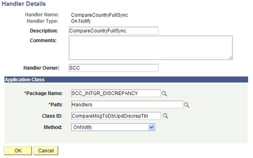

    2. Click the Details link and set up the following:
      This example illustrates potential Handler Details page field values.
      Example of Handler Details page field values for Application Class
      Description, Comments
      Optional fields
      Handler Owner
      Define a Handler Owner.
      Application Class- Package Name, Path, Class, Method
      In the Application Class section, select the Package, Path, Class and the Method to be invoked

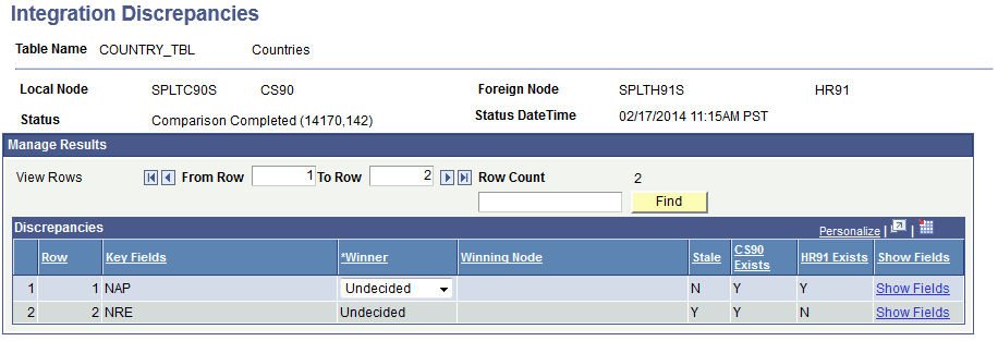

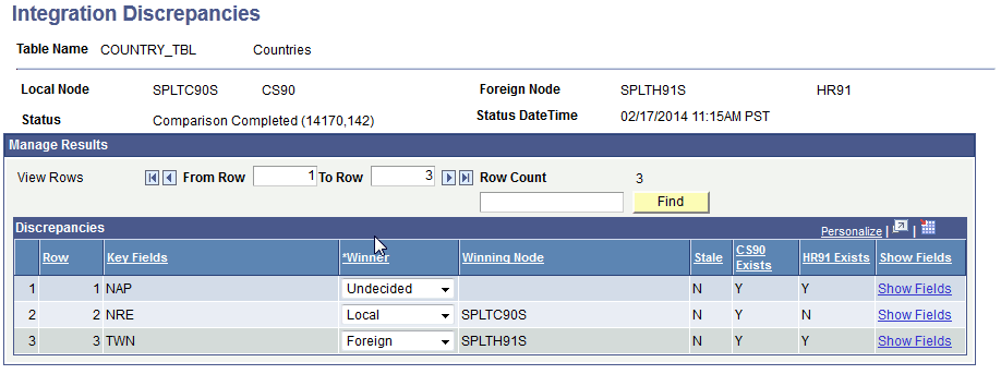

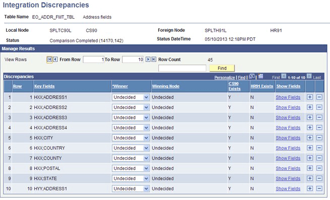

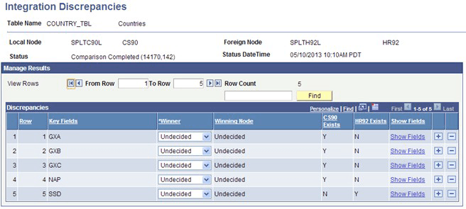

Reviewing Integration Discrepancy Results
To run on the CS instance:
  1. Confirm successful FULLSYNC message transaction subscription in the Integration Broker Monitor.
  2. Review the results on the Integration Discrepancies pages.

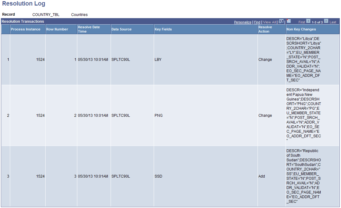

Configuring Resolution Methods
The Utility resolves data discrepancies between databases using either of two delivered resolution methods. Both methods are invoked by the Resolve Discrepancies process (Application Engine SCC_DISCREP3). Either resolution method may be used independent of the method used for data compare.
Method Description
SCCJAVA1
Apply winner via Java jdbc.
SCCSYNCMSG1
Apply winner via Synchronous Message.

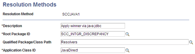

Access the Resolution Methods page (Set Up SACR, and then System Administration, and then Utilities, and then HCM Integration, and then Resolution Methods).
This example illustrates the fields and controls on the Resolution Methods page. You can find definitions for the fields and controls later on this page.
Description
The description for the resolution method.
Root Package ID
The application package used for the resolution method.
Qualified Package\Class Path
The class path being used.
Application Class ID
The application class ID being used.

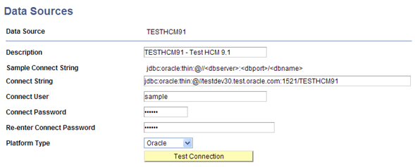

Defining Data Sources
In order to use the Java JDBC method, you must define a data source for the HCM database. You need not define a data source for the CS database instance.
Important:
Define the data source name to match the Node name of the HCM database.
The sample connect string is platform-specific. Select the appropriate Platform Type from the drop-down list to see examples of the connect string relevant to the database platform.
Access the Data Sources page (Set Up SACR, and then System Administration, and then Utilities, and then HCM Integration, and then Data Sources)).
This example illustrates the fields and controls on the Data Sources page. You can find definitions for the fields and controls later on this page.
Data Sources page
Description
Enter the description for the data source.
Sample Connect String
The displayed text changes based on the selected Platform Type.
Connect String
Enter the connect string, following the correct platform parameters.
The syntax for the connect string uses the thin-style service name.
Connect User
Enter the connect user ID.
Connect Password
Enter the password for the connect user ID.
Re-enter Connect Password
Re-enter the password for the connect user ID.
Platform Type
Supported platform types.
Test Connection
Click this button to test the connection. A successful connection triggers a “success” message; an unsuccessful connection throws up a Java error message.

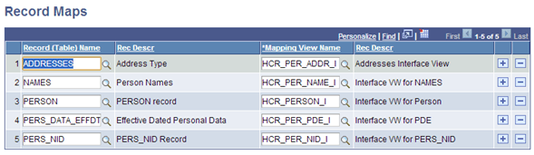

Defining Record Maps
When the Comparison process runs, the program evaluates the Record Maps definitions and selects data using any defined Mapping View Name instead of selecting the columns from the base table definition.
Record Maps are not required. Data comparisons can be done directly between the tables; however Record Maps are necessary when you want to omit columns or rows, or reformat columns for comparison. This allows for configuration and extensibility in several ways:
  • Exclude audit fields such as LASTUPDDTTM.
  • Exclude other data fields.
  • Compare records between databases where record definitions are different.
  • Include custom logic, such as custom selection criteria in SQL View text.
Access the Record Maps page ((Set Up SACR, and then System Administration, and then Utilities, and then HCM Integration, and then Record Maps).
This example illustrates the fields and controls on the Record Maps page. You can find definitions for the fields and controls later on this page.
Record Maps page
Record (Table) Name
Enter the base SQL Table name.
Rec Descr
The Record Definition description for the base SQL Table.
Mapping View Name
Enter the SQL View name to be used. This must be a valid SQL View in Application Designer.
Rec Descr
The Record Definition description for the SQL View.

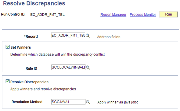

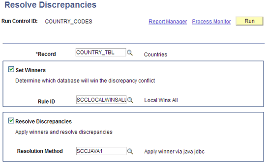

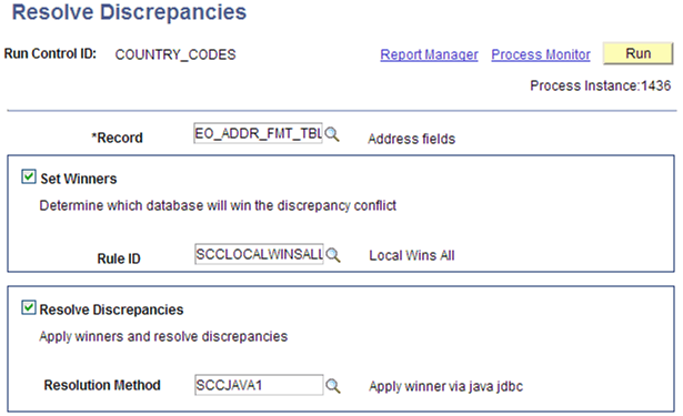

Defining Winner Rules
Usually most data discrepancies are due to specific reasons and should be investigated and resolved individually. For example, a broken integration transaction might be suspended in the Queue. To resolve this, the transaction should be fixed and resubmitted through the Queue.
There may be circumstances when data discrepancies can be resolved in the same way. Using a winner rule can simplify the task of setting the winners on the Integration Discrepancies page. For example, you may set some data discrepancy winners manually, but then use a winner rule to update the rest.
For the delivered winner rules, only those rows on the Integration Discrepancies page that are marked Undecided are updated according to the selected rule.
Winner Rules are used on the Resolve Discrepancies process run control page.
There are two delivered Winner Rule ID definitions:
Method Description
SCCFRGNWINSALL
Foreign Wins All (the designated foreign “target” database values are used to update the local database).
SCCLOCALWINSALL
Local Wins All (the designated local “source” database values are used to update the foreign database).
Access the Winner Rules page (Set Up SACR, and then System Administration, and then Utilities, and then HCM Integration, and then Winner Rules).
This example illustrates the fields and controls on the Winner Rules page. You can find definitions for the fields and controls later on this page.
Winner Rules page

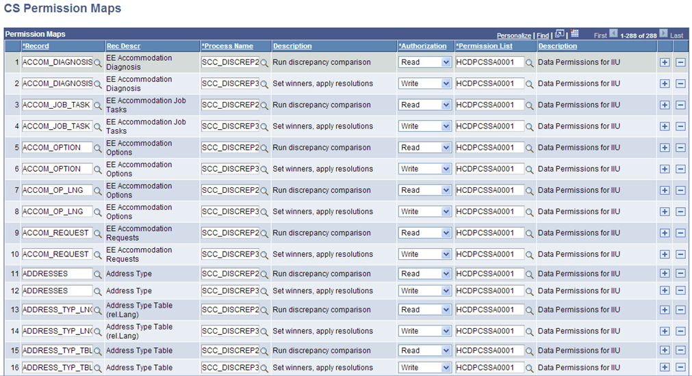

Defining Permission Maps
Permission Maps define security settings for read/write access to tables used by the Comparison and Resolution processes. Both CS and HCM environments must be configured with appropriate Permission Maps settings. Read/Write security authorization is assigned by Record name associated with a Permission List.
The SCC_DISCREP2 compare process uses the mapped view for comparison. The SCC_DISCREP3 resolution process uses the base table.
In the CS instance, access the CS Permission Maps page (Set Up SACR, and then System Administration, and then Utilities, and then HCM Integration, and then CS Permission Maps).
This example illustrates the fields and controls on the CS Permission Maps page. You can find definitions for the fields and controls later on this page.
Record
Enter the base table name.
Rec Descr
The Record Definition description of the base table.
Process Name and Description
The delivered SCC_DISCREP2 or SCC_DISCREP3 App Engine processes.
Authorization
Read or Write access to the specified record.
Permission List
Data Permission List that must be attached to Role to the User.
Description
The permission list description.

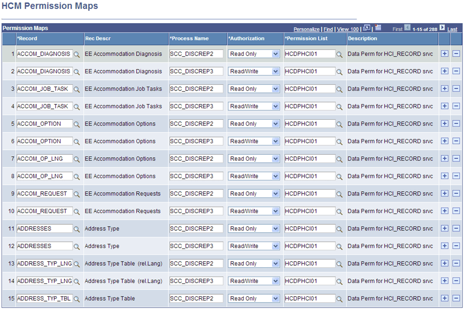

The Process Name provides an additional security attribute for the Synchronous Message method HCI_RECORD service operations to ensure the service request is made from an authorized program or component.
In the HCM instance, access the HCM Permission Maps page (Set Up Common Objects, and then Common Definitions, and then CS Integration, and then HCM Permission Maps).
This example illustrates the fields and controls on the HCM Permission Maps page. You can find definitions for the fields and controls later on this page.
Record
Rec Descr
Process Name
Authorization
Permission List
Description

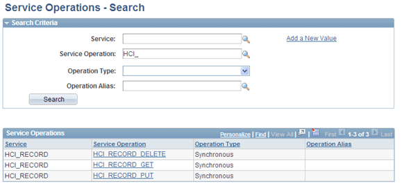

Configuring the HCI_RECORD Service Operations
The HCI_RECORD service is a synchronous request/response message which is invoked by the Synchronous Message resolution process to perform Add, Update, and Delete actions on data.
There are three service operations used by the Synchronous Message (SCCMSGSYNC1) resolution method:
  • HCI_RECORD_DELETE
  • HCI_RECORD_GET
  • HCI_RECORD_PUT
The HCI_RECORD service operations are used with the Synchronous Message resolution method. The following steps describe the HCI_RECORD service operations configuration.
These instructions are common to all HCM releases.
Configure HCI_RECORD Service Operations in HCM
This example illustrates the fields and controls on an example of the Service Operations search page (HCM).
Example of Service Operations search page (HCM)

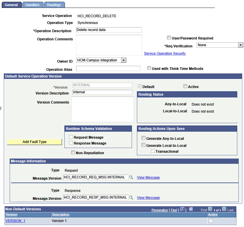

  1. Open Service Operation HCI_RECORD_DELETE.
    This example illustrates the fields and controls on an example of the Service Operations – General page (HCM).
    Service Operations page--General tab (HCM)

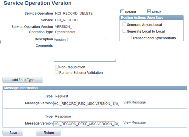

  2. In the Default Service Operation Version group box, select the Active check box and click Save.
  3. In the Non-Default Versions group box, click the VERSION_1 link.
    This example illustrates the fields and controls on the Example of Service Operation Version page (HCM).
  4. Select the Active check box and click Save.
  5. Click Return.

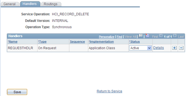

  8. Select the Handlers tab to activate the On-Request Handler, as shown below.
    This example illustrates the fields and controls on an example of the Service Operations – Handlers page (HCM).
    Example of Service Operations - Handlers page (HCM)

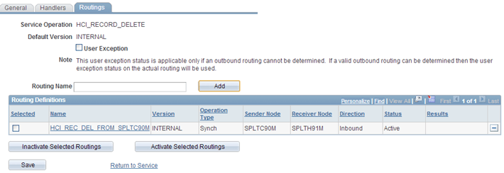

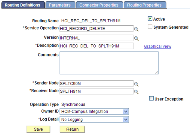

  9. Select the Routings tab to add a routing to the sender database.
    (In this example, the SPLTC90M database is the sender, so the routing is named HCI_REC_DEL_FROM_SPLTC90M.)
    This example illustrates the fields and controls on an example of the Routing Definitions page (HCM).
    Example of Routing Definitions page (HCM)

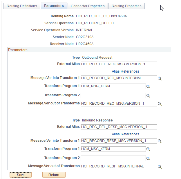

  10. Enter a Description, Sender Node, and Receiver Node.

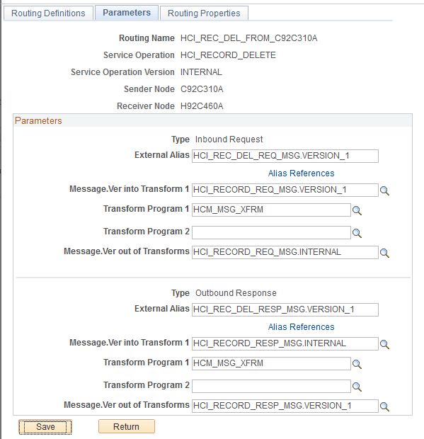

  11. On the Parameters tab, enter the required information for the Inbound and Outbound requests.
    This example illustrates the fields and controls on an example of the Parameters page (HCM).
    Example of Parameters page (HCM)
    • The Inbound Request transformation program is HCM_MSG_XFRM.
    • The Outbound Response transformation program is HCM_MSG_XFRM.
    • The External Alias is changed to VERSION_1 in both cases.
    On PeopleTools (PT) versions 8.55 and later, all synchronous transformation programs are replaced with HCM_MSG_XFRM. For earlier PT versions, the transformation program for requests is now HCM_MSG_XREQ; and HCM_MSG_XRSP for responses.

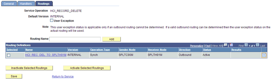

  12. Click Save and then click Return.
  13. Click Save on the Routings tab.
    This example illustrates the fields and controls on an example of the Service Operations – Routings page (HCM).
    Example of Service Operations - Routings page (HCM)
    This example illustrates the fields and controls on an example of the Service Operation Version page (CS).
    Example of Service Operation Version page (CS)

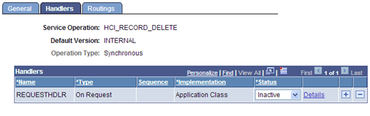

  8. Select the Handlers tab to confirm that the On-Request Handler is Inactive.
    This example illustrates the fields and controls on an example of the Service Operations – Handlers page (CS).
    Example of Service Operations - Handlers page (CS)
  11. On the Parameters tab, enter information as shown in the screenshot below:
    This example illustrates the fields and controls on an example of the Parameters page (CS).
    Example of Parameters page (CS)

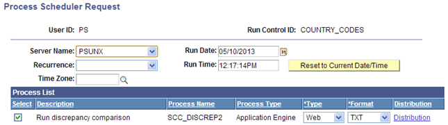

Running Discrepancy Comparison
The Run Discrepancy Comparison page is the primary run control page where you set the list of tables to be compared and the methods for the data compare. The process initiates a comparison of the data for the listed records between the databases, and logs discrepancy results in the Integration Discrepancies tables for review.
Individually add record names to the grid or populate a list of records from a message definition by using the Append Table Names from Message button.
When populating the list of records from a message, choose the INTERNAL version of the message if it exists for the selected message name.
  • Run the compare process as many times as desired for any set of tables. When a process is launched, any previous data discrepancy results for the same tables are deleted and refreshed with the latest results of the compare.
  • If using the Database Link method, confirm that a Database Link Map is defined for all the records you specify. The process aborts if it does not find an entry in the Database Link Map table for the specified record.
  • Confirm that Permission Maps are defined for all records you specify for comparison. Confirm that the user running the process has an appropriate permission list defined. The process aborts if it does not find an entry in the Permission Maps table for the record name being compared.
Access the Run Discrepancy Comparison page (Set Up SACR, and then System Administration, and then Utilities, and then HCM Integration, and then Run Discrepancy Comparison).
This example illustrates the fields and controls on the Run Discrepancy Comparison page. You can find definitions for the fields and controls later on this page.
Foreign Node Name
Enter the data source name; this must be a valid Integration Broker Node name.
Comparison Method
Select the comparison method to be used. The delivered choices include SCCDBLINK and SCCJDBC.
Click this button after the Message Name and Message Version fields are entered.
Message Name
Select the message name for which records are being compared.
Message Version
Select the desired message version.
Record
The base table being compared.
Mapping View Name
A view defined on the Record Map for the base table.
Record Description
The description of the base table, or mapping view if defined.
Reviewing Integration Discrepancies
Once a comparison is run, all data discrepancies found by the process appear on the Integration Discrepancies page. The data results displayed in the Integration Discrepancies page are specific to each table name. Use the results to analyze the data that is out of sync, and then investigate its cause.
Once data discrepancies are resolved and the data is re-synced, they no longer appear on this page on subsequent comparisons of the table.
Data discrepancies due to errors in Integration Broker processing should be investigated and then resubmitted for proper Integration Broker handling.
Select the Winner value for all data rows that are to be re-synced using the Resolve Discrepancies process.
  • Foreign: the row or values in the foreign node replace those in the local node.
  • Local: the row or values in the local node replace those in the foreign node.
  • Undecided: nothing changes
Access the Integration Discrepancies page by selecting the appropriate record name on the search record (Set Up SACR, and then System Administration, and then Utilities, and then HCM Integration, and then Integration Discrepancies.).
This example illustrates the fields and controls on an example of the Integration Discrepancies page, after the initial comparison is done.
Example of Integration Discrepancies page (1 of 2)
This example illustrates the fields and controls on an example of the Integration Discrepancies page, after the Stale data column = Y and the system has made the Winner field unavailable for entry.
Example of Integration Discrepancies page (2 of 2)
The page displays data rows that are missing in either of the database instances and where field values are different.
View Rows
The Row Count shows the total number of data rows identified by the compare.
Enter numbers in the From Row and To Row fields and then click the Find button to navigate between many rows.
Find
Enter a search value in the box and click this button to locate a value string within results.

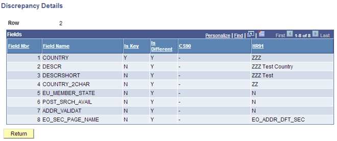

Key Fields
The key field values for the data rows on the table that was compared.
Winner
Select the value for the resolution process to follow, if desired. Options are: Undecided, Foreign, or Local.
Winning Node
The description of the node set by the value selected in the Winner field.
Stale
Indicates that the data has changed in the foreign or local database after the Discrepancy Comparison process was run.
Y = Stale data conditions are detected.
N = Data is unchanged since the Discrepancy Comparison process was run.
When Stale = Y, the Resolve Discrepancies process has detected data that has changed since the Discrepancy Comparison process was run. The Winner field becomes unavailable for such rows. Investigate why this data may have changed. The next run of the Discrepancy Comparison process may no longer show a discrepancy for such rows of data if the values are back in sync.
Exists columns
The Local and Foreign node names appear in the column header and appear if the data row exists.

Show Fields
Click the link to access the Discrepancy Details page. This page shows field value differences for the selected row.
Access the Discrepancy Details page (Click the Show Fields link for any row on the Integration Discrepancies page).
This example illustrates the fields and controls on the Discrepancy Details page.

You can use the Resolve Discrepancies page to run the process for each table in which data discrepancies have been found, and that you determine should be updated through the resolution process. Winner dispositions are set on the Integration Discrepancies page. It is important to ensure that data rows selected to be updated by the resolution process have been thoroughly investigated and this method of re-sync is desired.
The resolution process is performed by table. Run the resolution process for all tables with data discrepancies. If there are multiple tables related to an entity, be sure all table data discrepancies are resolved.
Access the Resolve Discrepancies page (Set Up SACR, and then System Administration, and then Utilities, and then HCM Integration, and then Resolve Discrepancies).
This example illustrates the fields and controls on the Resolve Discrepancies page. You can find definitions for the fields and controls later on this page.
Record
Select the table name where data discrepancies are being resolved.
Set Winners
Select the check box if a Winner Rule is to be used. If selected, the process updates all Undecided rows on the Integration Discrepancies page with the selected winner rule logic (such as local wins, foreign wins).
Rule ID
Select the Rule ID to use.
Select the check box to apply winners and update data values in the databases accordingly.
Resolution Method
Select the resolution method being used for the updates.
Reviewing the Resolution Log
Access the Resolution Log page (Set Up SACR, and then System Administration, and then Utilities, and then HCM Integration, and then Resolution Log).
This example illustrates the fields and controls on the Resolution Log page. You can find definitions for the fields and controls later on this page.
Resolution Log page
When you run the Resolve Discrepancies process, the system logs all data discrepancies that are updated and displays them on this page. The log entries provide an audit history of the data updated through this process.
Process Instance
The Resolve Discrepancies process instance used.
Row Number
The row number from the Integration Discrepancies page that is updated.
Resolve Date/Time
The date and time when the Resolve Discrepancies process updated the row of data.
Data Source
The database that was used to provide the winner data values.
Key Fields
The key value(s) for the data row that has been updated.
Resolve Action
The action taken on the data row. Delivered values include: Add, Change, and Delete.
Non Key Changes
The value(s) for the additional non-key fields in the data row that has been updated.

  3. Confirm tables are listed in CS Permission Maps.
    This example illustrates the fields and controls on an example of the CS Permission Maps list.
    Example of table list

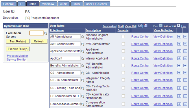

  4. Confirm User ID has an assigned Role of CS – IIU Administrator (this includes the data permission list for record permissions).
    This example illustrates the fields and controls on an example of the Roles page.
    Example of Roles page
  5. Run the Discrepancy Comparison process.
    This example illustrates the fields and controls on an example of the Run Discrepancy Comparison page.
    Example of Run Discrepancy Comparison run control page
    This example illustrates the fields and controls on an example of the Process Scheduler Request page.
    Example of Process Scheduler Request page for Run Discrepancy Comparison process
  6. Review Integration Discrepancies for both tables.
    This example illustrates the fields and controls on an example of the Integration Discrepancies page for COUNTRY_TBL.
    This example illustrates the fields and controls on an example of the Integration Discrepancies page for EO_ADDR_FMT_TBL.

  9. Resolve parent COUNTRY_TBL rows first, then run the Resolve Discrepancies process.
    This example illustrates the fields and controls on an example of the Resolve Discrepancies page for COUNTRY_TBL.
    Example of Resolve Discrepancies page (1 of 2)
    This example illustrates the fields and controls on an example of the Resolve Discrepancies page for EO_ADDR_FMT_TBL.
    Example of Resolve Discrepancies page (2 of 2)
