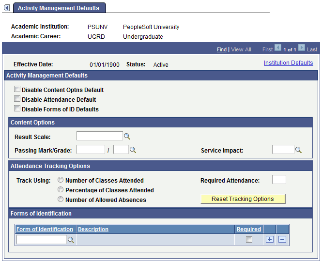

Activity Management Defaults (academic career)
ACAD_CAR_AM_DFLTS
Set Up SACR, and then Foundation Tables, and then Academic Structure, and then Academic Career Table, and then Activity Management Defaults
Set Activity Management default values specific to an academic career.

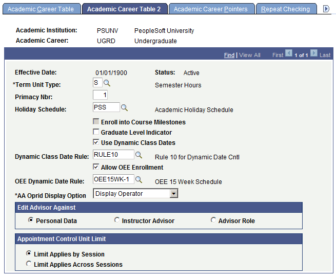

Setting Additional Academic Career Parameters
Access the Academic Career Table 2 page ((Set Up SACR, and then Foundation Tables, and then Academic Structure, and then Academic Career Table, and then Academic Career Table 2).
This example illustrates the fields and controls on the Academic Career Table 2 page. You can find definitions for the fields and controls later on this page.
Field or Control Description
Term Unit Type
Enter a term unit type to indicate what kind of units are calculated for this academic career. Values for this field are delivered with the system as translate values. These translate values can be modified.
Note: When processing transfer credit between academic careers with different term unit types, use the Unit Conversion Table page first to set up unit conversion rules.
Primacy Nbr (primacy number)
Enter the primacy number for this academic career. The system uses this number to determine a student's primary academic career when you consolidate academic statistics. The system also uses this number to prioritize financial aid applications when students are enrolled in multiple academic careers at the same time. The lowest number takes precedence.
Note: Coordinate the numbering with financial aid to avoid conflicts.
Holiday Schedule
Enter the holiday schedule for this academic career. The holiday schedule prevents scheduling classes for this academic career on designated holidays.
See Campus Community Fundamentals: Setting Up Holiday Schedules
Note: If you implement Campus Solutions and a separate instance of PeopleSoft Human Capital Management, read the relevant documentation about CS-HCM Integration to understand the setup, functional, and technical implementation considerations. See: Integrating Person Data Integrating Setup Data Monitoring Integrations Using the Integrity Utility See Information Center: CS-HCM Integration for PeopleSoft Enterprise Campus Solutions in My Oracle Support (ID 2091799.2).
Enroll into Course Milestones
Select this check box to enable a course milestone to be created when a student enrolls in a class for which the milestone is selected on the Course/Milestone Link page in the Course Catalog.
The Enroll into Course Milestones check box must also be selected on the Academic Institution 2 page.
See Defining Academic Institutions.
See Student Records: Creating Course Offerings.
(NZL) Select the check box to enable the tracking of NQF (national qualifications framework) Unit Standards for a specific career.
See Student Records: Understanding New Zealand Government Reporting
Graduate Level Indicator
Select to indicate that this academic career qualifies as graduate level for reporting purposes.
Otherwise, this field is informational only.
Use Dynamic Class Dates
Select to make available the Dynamic Date page of the Academic Program Table component. You use the Dynamic Date page to set up reasons and penalties for canceling, withdrawing from, and dropping classes. These reasons and penalties relate to the corresponding landmark date deadlines on the dynamically calculated academic calendars, and they apply to students according to their academic program.
Dynamic Class Date Rule
Enter a dynamic date rule to have the system assign that rule to all course offerings that you tie to this academic career. You can override this default rule on an offering-by-offering basis through the Offerings page. This field prompts you with only the dynamic class date rules that have not been designated for open entry/exit (OEE) enrollment on the Dynamic Class Dates page.
Allow OEE Enrollment (allow open entry/exit enrollment)
Select to have all course offerings that you tie to this academic career permit, by default, the scheduling of OEE class sections. You can override this default on an offering-by-offering basis on the Offerings page of the Course Catalog component. If you select this check box, the OEE Dynamic Date Rule field becomes available.
OEE Dynamic Date Rule (open entry/exit dynamic date rule)
An OEE dynamic date rule is a dynamic class date rule that has been designated for OEE enrollment. The enrollment engine uses the OEE dynamic date rule to calculate significant class dates for a student whenever a student enrolls in an OEE class. This field is available for edit only if you select the Allow OEE Enrollment check box on the preceding page of this component. Select an OEE dynamic date rule to have the system assign that rule to all course offerings that you tie to this academic career. You can override this default rule on an offering-by-offering basis through the Offerings page of the Course Catalog component. This field prompts you with only the dynamic class date rules that have been designated for OEE enrollment on the Dynamic Class Dates page.
AA Oprid Display Option (academic advisement operator identification display option)
Select an available option to display or hide the operator ID, operator name, or Operator field on the advisement report. The default value is Display Operator.
Display Name: If you select this option, the system displays the operator's name on the advisement report.
Display Operator: If you select this option, the system displays the operator's ID on the advisement report.
Do Not Display: If you select this option, the system does not display the Operator field on the advisement report.
Edit Advisor Against
Indicate which view the system should use when prompting you to assign an advisor for a student in this academic career. You assign advisors to students on the Student Advisor page. Your selection here appears on the Academic Program page. Select from these options:
Personal Data
Prompts against all people with a PERSONAL_DATA record in the PeopleSoft system.
Instructor Advisor
Prompts against all people defined as instructors and advisors on the Instructor/Advisor Table page, as defined for this academic career.
Advisor Role
Prompts against all people defined as advisors on the Instructor/Advisor Table page, as defined for this academic career.
Appointment Control Unit Limit
Indicate how to apply enrollment appointment unit limits when an appointment created for a single session is valid for other sessions within the term. Select from these options:
Limit Applies by Session
Enrollment unit limits for enrollment appointments are applied to each individual session for which the appointment is valid.
If:
  • Session A is the appointment control session for Sessions B and C in a term, and
  • Each session has a limit of 6 units or greater, and
  • The overall term limit is 18 units or greater, and
  • A student has an appointment limit restricting enrollment to a total of 6 units,
Then: The student can enroll in 6 units in each Session (A, B and C).
Limit Applies Across Sessions
If:
Then: The student can enroll in classes with a combined total of 6 units across sessions A, B and C (session and term unit limits still apply). For example, if the student enrolls in 6 units in Session A, the student cannot enroll in classes in sessions B or C.
See Student Records: Understanding Enrollment and Validation Appointments
See Student Records: Setting Up Enrollment and Validation Appointments
See Student Records: Assigning and Maintaining Appointments for Individual Students
See Student Records: Assigning Enrollment and Validation Appointments in Batch

Access the Activity Management Defaults page for academic careers (Set Up SACR, and then Foundation Tables, and then Academic Structure, and then Academic Career Table, and then Activity Management Defaults).
This example illustrates the fields and controls on the Activity Management Defaults page for academic careers. You can find definitions for the fields and controls later on this page.
This page is available when the Enable Career Defaults field is selected on the Academic Institution 9 page. All fields are defined on the Academic Institution 9 page, but you can set values here specific to an academic career.
Anonymous Grading
Override
Select to override the default settings from the Academic Institution table.
When you override the default settings, you can change how anonymous grading is displayed at this level as well as disable anonymous grading.
