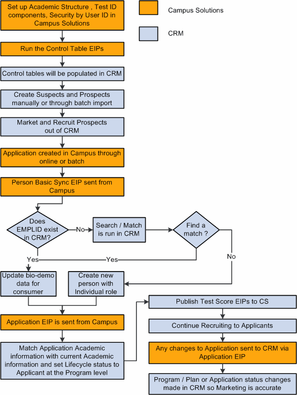

Workflow illustrating the system steps to pass messages between Campus Solutions and CRM when suspects become applicants.
Example of message flow for Suspect to Applicant

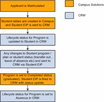

Workflow illustrating the system steps to pass messages between Campus Solutions and CRM when applicants become alumni.
Example of message flow from Applicant to Alumnus
