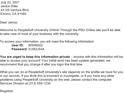

The PeopleSoft system comes with these items specifically for generating the notification letters:
  • A sample Microsoft Word template called CCLTROPR.doc for printing notification letters.
    You can modify the template or use it to create new templates so that you can create different letters. If you use this template and you do not rename it, the letter code that you create must be named OPR.
  • A unique SQC called CCLTRWOL.
    The CCLTRWOL SQC generates the variable data necessary for the password notification letters associated with the letter code that you create. You should not modify this SQC.
Example
Here is an example of a password notification letter created with the sample template CCLTROPR.doc:
Example of an online access letter to a student from an institution.
Example of password notification letter
WARNING:
When you merge the letter template with the extract files, a copy of the letter is saved on the local drive of the computer that was used to merge and print the letters. Be sure to delete these local copies because they contain the nonencrypted passwords.
