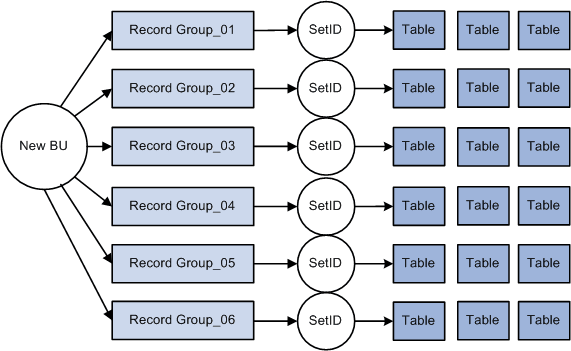

Example of Business Unit and Tableset ID Association
This diagram illustrates how the business unit, record groups, and tableset ID are associated. The business unit and tableset ID can have the same value:
A sample association between a business unit, six record groups, and their corresponding SetIDs.
Tableset sharing
