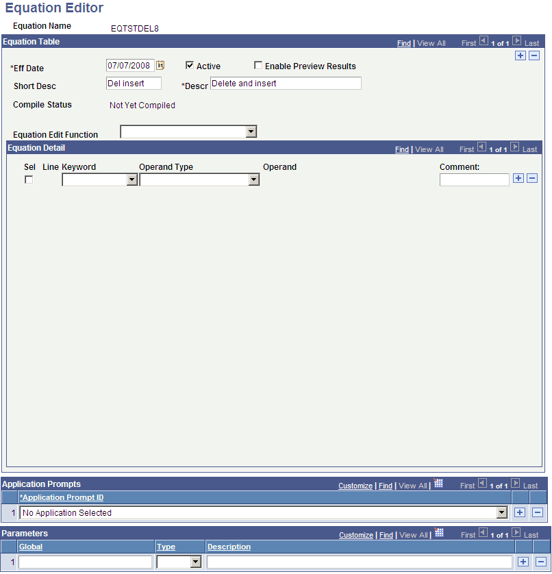

Access the Equation Editor page (Set Up SACR, and then Common Definitions, and then Equation Engine, and then Equation Editor).
This example illustrates the fields and controls on the Equation Editor (EQTSTDEL8) page. You can find definitions for the fields and controls later on this page.
Create an equation name based on established naming conventions for your organization.
