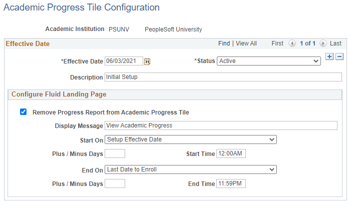

Configure the Academic Progress Tile
Use this page to disable the academic progress report on the Academic Progress tile during a specific date range.
Access the AA Tile Configuration page (Set Up SACR, and then Common Definitions, and then Self Service, and then Fluid Configuration, and then AA Tile Configuration).
This example illustrates the fields and controls on the Academic Progress Tile Configuration page. You can find definitions for the fields and controls later on this page.
Field or Control Description
Remove Progress Report from Academic Progress Tile
Select to disable academic progress report. The report isn't automatically run, and academic progress doesn't appear on the Student homepage. It is displayed only after students select the Academic Progress tile.
Display Message
Enter a message to encourage students to select the tile.
Start On Date
End On Date
Define the date range in which the academic progress report is disabled.

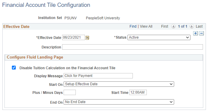

Configure the Financial Account Tile
Use this page to disable tuition calculation on the Financial Account tile.
Access the Financial Account Tile Configuration page (Set Up SACR, and then Common Definitions, and then Self Service, and then Fluid Configuration, and then SF Tile Configuration).
This example illustrates the fields and controls on the Financial Account Tile Configuration page. You can find definitions for the fields and controls later on this page.
Students' access to the Financial Account tile is determined by the institution set. Configuring the Financial Account tile is used in combination with the SF institution set.
The tuition calculation control Auto Calculate Self Service is used to define the terms for tuition calculation. For more information on calculating tuition in self-service, see:
Configure Fluid Landing Page
Disable Tuition Calc on the Financial Account Tile
If you select this, tuition calculation isn't run until after students select the Financial Account tile.
Display Message
Start On Date
End On Date
Define the date range in which tuition calculation is disabled on the Financial Account tile.

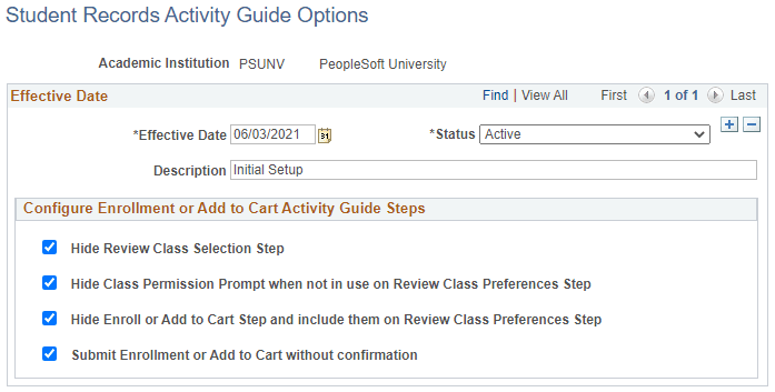

Configure Student Records Activity Guide Options
Use this page to configure the options that appear to students when they complete the enrollment or add to cart tasks.
Access the Student Records Activity Guide Options page (Set Up SACR, and then Common Definitions, and then Self Service, and then Fluid Configuration, and then SR Activity Guide Options).
This example illustrates the fields and controls on the Student Records Activity Guide Options page. You can find definitions for the fields and controls later on this page.
Configure Enrollment or Add to Cart Activity Guide Steps
In this region, select the options that determine how the enrollment activity guide appears to students.
Hide Class Permission Prompt when not in use on Review Class Preferences Step
If you're not using class permission, select this option to hide Permission Number from the Review Class Preferences step.
Submit Enrollment or Add to Cart without confirmation
Hide the Confirmation button, but submit students' enrollment or cart.

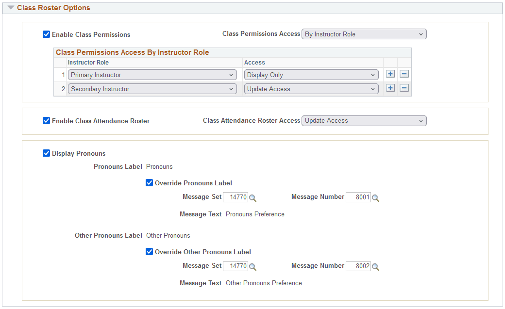

Class Roster Options
This example illustrates the fields and controls on the Class Roster Options page. You can find definitions for the fields and controls later on this page.
Enable Class Permissions
Select to allow instructors to access class permissions. Show Class Permissions appears on the fluid Class Roster page.
Class Permissions Access
The option you select indicates whether faculty members have the ability to update data in permissions or attendance fluid pages. This setting works in combination with the Enable Class Permissions checkbox.
  • By Instructor Role: This option lets you set different access types for each instructor role. Instructor roles are determined from the class schedule for the class section.
    For example, you can set a Primary Instructor to have display-only access, a Secondary Instructor with update access, and so on.
  • Display Only: This option means that all faculty members will have display-only access. They won't be able to edit anything.
  • Update Access: This option gives all faculty members the ability to update data.
Enable Class Attendance Roster
Select to allow instructors to access the class attendance roster. Show Attendance Roster appears on the fluid Class Roster page.
Class Attendance Roster Access
The options that are available here work in the same way as those in Class Permissions Access.
Display Pronouns
The options in this region control whether a students' pronouns appear on the class roster. You can override the field label by using your own message catalog.
