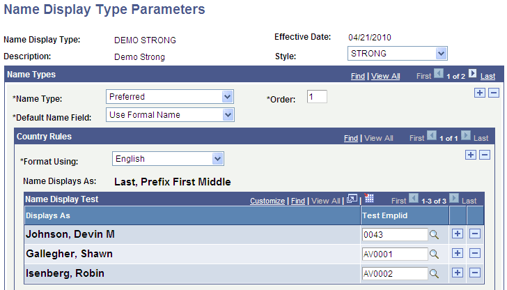

This example illustrates the fields and controls on the Name Display Type Parameters (1 of 2). You can find definitions for the fields and controls later on this page.

Name Types
Field or Control Description
Name Type
Select a name type, which is defined on the Name Type Table page. You can assign multiple name types (such as Primary, Preferred, and Legal) to each Name Display Type. The value selected here determines which name type the system displays for a person's record on the Name Display subpage at Level 0 in a component.
Order
Rank the Name Type in the Name Type hierarchy for the Name Display Type. The system uses this hierarchy in the Display Name resolution process, and determines the particular name display options to use for a display name.
Default Name Field
Select from three delivered options: Use Formal Name, Use Name, or Use Name Display. If no Country Rules are specified, the Default Name Field value is used to derive the Display Name.
Country Rules
You can define multiple sets of country rules for each Name Type. For example, your institution might define English country rules for the primary name type and Belgian country rules for the preferred name type. If you specify country rules, then you must select an option in the Name Field group box.
Format Using
The system only displays Campus Solutions-supported countries in this list.
Test EmplID
Add person IDs to this grid, which allows you to select test IDs to see how a name actually appears on a page based on the rules entered. You can only add IDs whose names include parts associated with the country.
