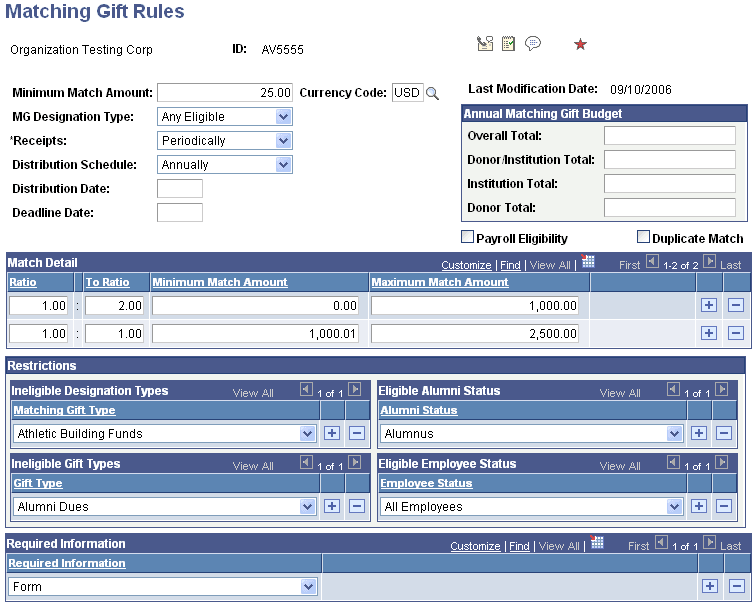

Access the Matching Gift Rules page (Contributor Relations, and then Session Management, and then Matching Gifts, and then Add/Update Matching Rules, and then Matching Gift Rules).
This example illustrates the fields and controls on the Matching Gift Rules page (1 of 2). You can find definitions for the fields and controls later on this page.
This example illustrates the fields and controls on the Matching Gift Rules page (2 of 2). You can find definitions for the fields and controls later on this page.
Field or Control Description
Minimum Match Amount
Enter a minimum amount for gifts that the organization matches. The organization only matches gifts that are equal to or greater than the amount in this field. If the gift meets this amount, the matching gift program then considers if it is given to an appropriate designation (set up on the Restrictions page). If the gift passes this test, then the matching gift program considers the matching ratios.
Currency Code
Note: The currency you select here applies to all amount fields on this page.

Annual Matching Gift Budget
Overall Total
Enter the organization's total annual matching gift budget. This amount represents the total amount the organization will donate in matching gift payments to your institution as well as other institutions for the current year.
Donor/Institution Total
Enter the maximum monetary amount the organization will match toward one donor's gifts to your institution this year.
Institution Total
Enter the maximum monetary amount the organization will give to your institution in matching gift payments this year.
Donor Total
Enter the maximum amount the organization will pay in matching gifts for donations made by one donor to your institution as well as other institutions this year.
Match Detail
The following fields are used in the automated matching gift process.
Ratio and To Ratio
Enter the formula by which an organization calculates the amount it matches for each regular donor gift to your institution. Ratio ranges can include fractions such as 1.25:1. This field is used in the automatic calculation of the expected matching gift amount.
You can enter multiple match ratios as long as the amount ranges associated with each ratio do not overlap.
Minimum Match Amount and Maximum Match Amount
For each ratio, enter a minimum amount and maximum amount. These fields are used in the automatic calculation of the expected matching gift amount.
For example, if the matching gift organization matches 100 percent of gifts from 25 to 25,000 USD, then the first minimum amount field on this page should be set to 25 USD and the first Ratio Minimum Amount field should be left blank or set to 0 USD. The maximum amount field should include the cap for the match ratio, or 25,000 USD. The system calculates that all qualified gifts are met at 100 percent up to 25,000 USD.
If the organization matches gifts larger than 25,000 USD at a different ratio (perhaps 0.5:1) then the minimum amount for the next ratio would be 25,000.01 with the appropriate cap entered in the maximum amount field.
Restrictions
Ineligible Designation Types
Select the designation types that are not eligible for an organization's matching gift program. This field is used in the automatic calculation of the expected matching gift amount.
Ineligible Gift Types
Select the ineligible gift types that your organization does not match, such as dues or deferred gifts. This field is used in the automatic calculation of the expected matching gift amount.
Eligible Alumni Status
Select the appropriate eligible alumni status. Alumni status refers to the status a donor must have as a formal student of your institution in order for the organization to match gifts made to your institution. Values for this field include Alumnus, Attendance Requirement, Child or Spouse Attended, and Graduate.
Values for this field are delivered with the system as translate values. You can modify these translate values.
Eligible Employee Status
Select the appropriate eligible employee status. Employee status refers to the status a donor must have as an employee at the organization for it to match gifts. Values for this field include All Employees, All Full-Time Employees, Employees in US or Possessions, Full-Time Salaried Employees, Non-Employee Directors, Period of Service, Permanent Part-Time, Retired Employees, Spouses of Eligible Employees, Spouses of Eligible Retirees, and Widows/Widowers of Eligible Retirees.
