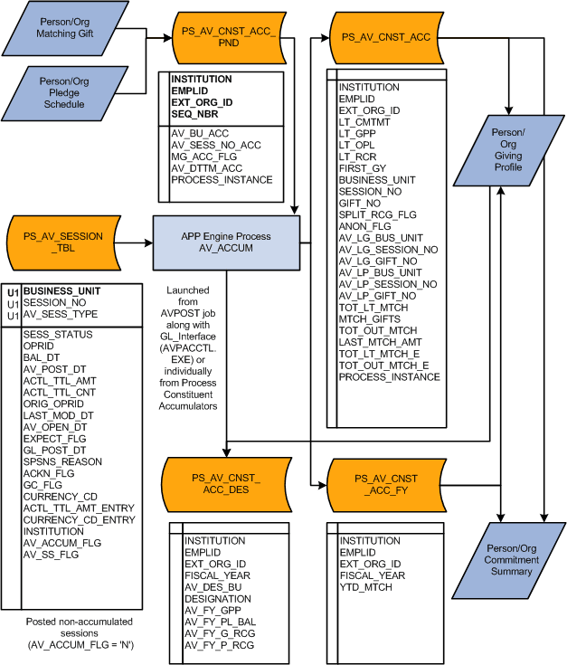

Understanding the Constituent Accumulators Process
The Constituent Accumulators process builds accumulator tables that summarize data utilized by the Giving Profile and Commitment Summary pages. You can run this process as part of posting any session type using the AVPOST multi-process job, or run it independently through its own run control definition.
Your institution should decide if the information displayed on the Giving Profile and Commitment Summary pages needs to display the latest posted sessions. If so, the Constituent Accumulators process can be run along with the GL Interface in the AVPOST multi-process job. If not, the Constituent Accumulators process can be run independently in an off-peak processing window. Regardless of the run method, the process always attempts to complete all posted and nonaccumulated sessions in the system.
Here is how the process works:
  1. Constituent records are loaded from the Constituent Pending Accumulation table (AV_CNST_ACC_PND) and locked.
  2. Temporary accumulator records are calculated and updated from temporary tables.
  3. Locks on constituent records are released.
  4. Related constituent records from posted, nonaccumulated sessions are loaded and locked.
  5. Temporary accumulator records are calculated and updated from temporary tables.
  6. Locks on constituent records are released.
  7. The accumulator flag on the session table (AV_SESSION_TBL.AV_ACCUM_FLG) is set to 'Y'.
If a session does not accumulate because a constituent accumulator record is locked by another accumulator process, the system skips the session and processes it the next time the accumulator process runs. The locked constituent and the locking process instance is indicated in the Service Operations Monitor Log.
If locking problems persist and the constituent accumulator record is locked by a process that is no longer running, check the constituent accumulator table (PS_AV_CNST_ACC) for records where the PROCESS_INSTANCE field is not equal to zero. Add all constituent records with a nonzero, nonprocessing PROCESS_INSTANCE to the pending accumulation table (PS_CNST_ACC_PND) and reset the locking records PROCESS_INSTANCE to zero. Re-run the process. After the process runs, the pending accumulation table should be empty, and all posted sessions should be processed.
The following graphic illustrates the Constituent Accumulators process flow, from the person or organization's matching gift or pledge schedule, through to the person or organization's commitment summary, including all of the tables affected during processing:
This graphic illustrates the Constituent Accumulators process flow in the Contributor Relations system:
