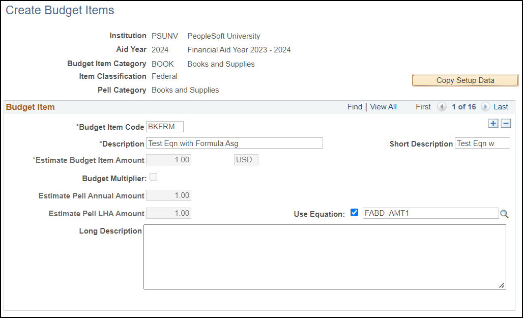

Defining Budget Items
Access the Create Budget Items page (Set Up SACR, and then Product Related, and then Financial Aid, and then Budgets, and then Budget Items, and then Create Budget Items).
This example illustrates the fields and controls on the Create Budget Items page. You can find definitions for the fields and controls later on this page.
You can have multiple budget items for each category. If the budget amounts within a category differ depending on the type of term, you must create a separate budget item for each term.
Field or Control Description
Copy Setup Data
Click to access the Copy Budget Item Data page and copy the information on this page from one combination of academic institution, aid year, and budget item category to another.
Budget Item Code
Enter a code to identify budget items within a category. For example, the Housing budget category could have separate budget items for students living on campus, off campus, with parents, and in married student housing.
Budget Item Amount
Enter the amount per term for this budget item. Financial aid budgets, except for Pell budgets, are term-specific, so each budget item should reflect the term amount for that budget item.
Budget Multiplier
Select to multiply the budget item amount by a student's value for a particular field. Then select a field from the available list. The system takes the budget item amount and multiplies it by the value of the budget multiplier field. The available budget multiplier fields are:
COURSE_LD_PCT
FA_NUMBER_OF_WEEKS
FA_TERM_EFFSEQ
FA_UNIT_ANTIC
FA_UNIT_COMPLETED
FA_UNIT_CURRENT
FA_UNIT_IN_PROG
REFUND_PCT
UNIT_TAKEN_FA
UNIT_TAKEN_FA_CL
WEEKS_OF_INSTRUCT
Use the budget multiplier to build budget items on a per unit or per week basis. For example, if you charge tuition based on the number of units that a student takes, you can enter the per unit amount as the budget item amount. Then select the Budget Multiplier check box and select a field that represents units (options include FA units taken, units anticipated, units in progress, and current units).
The budget multiplier can also reduce the budget item amount for students who are not taking a full load or who receive a refund. Because these field values are a percentage, they can reduce the budget item amount. For example, to adjust a books budget item based on the student's course load, you select the Budget Multiplier check box and select COURSE_LD_PCT as the multiplier. Full-time students would receive 100 percent of the budget item amount, three-quarter-time students would receive 75 percent, and so on.
Pell Annual Amount
Available only for budget categories assigned to a Pell category on the Create Budget Categories page. Enter the annual—not term—Pell budget for this item.
The budget multiplier does not affect the Pell annual amount.
Note: Because graduate students are not eligible for Pell Grants, leave this field blank for graduate students.
Pell Less Half Annual Amount
Available only for budget categories assigned to a Pell category on the Create Budget Categories page. Enter the annual—not term—Pell budget for this item. Displays the Pell amount for less than half-time enrollment.
Use Equation
Select this check box and user-defined equation from the list of values to use the Equation Engine to determine the Budget Item amounts.
Note: Only equations created using Application Prompt ID of FA Budget Item Amount are available in the list of values.
When you select Use Equation, the field labels of Budget Item Amount, Pell Annual Amount, and Pell LHA Amount change to Estimate Budget Item Amount, Estimate Pell Annual Amount, and Estimate Pell LHA Amount, respectively, and make those fields and the Currency and Budget Multiplier fields read-only.

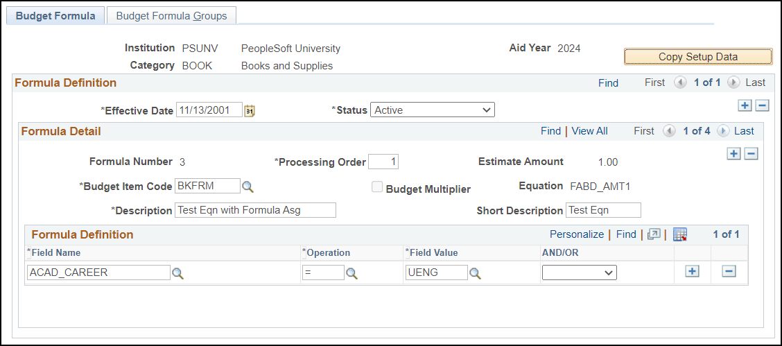

Defining Budget Formulas
Access the Budget Formula page (Set Up SACR, and then Product Related, and then Financial Aid, and then Budgets, and then Budget Formulas, and then Budget Formula.
This example illustrates the fields and controls on the Budget Formula page. You can find definitions for the fields and controls later on this page.
Budget Formula page
Effective Date
The Effective Date field on this page dictates which effective-dated translate table to use when retrieving valid values for each Field Name used in the Formula Definition.
Always review Budget formulas when valid field values are updated. A new effective-dated row may be necessary to use the proper field values.
Formula Detail
Copy Setup Data
Click to access the Copy Budget Formula Data page and copy setup data on the Budget Formula page from one academic institution, aid year, and budget category combination to another.
Budget Item Code
Select the budget item for which you are defining a formula.
Budget Multiplier
Selected if you selected it on the Create Budget Items page. The multiplier field that you selected also appears.
Equation
Displays the amount equation associated to the Item Code. If Item Code is associated with an amount equation, the Amount field displays as Estimate Amount.
Formula Definition
Create a budget formula to define a student's eligibility for this item. For example, if the student must be an undergraduate, the field name would be ACAD_CAREER, the operation would be = (equals), and the field value would be UGRD.
Field Name
A set of predefined fields that enable you to compose selection criteria to assign budget items. The Values for Field Name subtopic lists the available values.
Note: If you select STDNT_GROUP as the field name, use the Budget Formula Groups page to specify field values and operations for the STDNT_GROUP criteria.
Operation
Indicates the relationship between the field name and its field value used to select students. The Available Operations subtopic describes the functions of the available values.
Field Value
Select a field value that indicates the required value of the field from Field Name. The system displays only field values related to the selected field name.
AND/OR
Select an AND/OR connector to indicate that other field names, statements, or criteria must be included in this formula. For example, a student must be an undergraduate AND have full time enrollment for a book allowance; the graduate student must be a graduate AND be enrolled in fall OR spring terms to be eligible for a study trip allowance. If you create conditional statements, the system processes only simple OR statements. Each conditional statement must be mutually exclusive.
Note: Do not select an AND/OR connector in the last row of your formula.
This table lists all available field names from which you compose selection criteria to assign budget items.
Select only field names that are valid for the particular aid year.
Budget Formula Field Names
ACADEMIC_LOAD
CUR_PARTICIPANT_2
INTERESTED_IN_WS
ACAD_CAREER
CUR_PARTICIPANT_3
ISIR_STU_ENRL_STAT
ACAD_GROUP_ADVIS
CUR_PARTICIPANT_4
MARITAL_STAT
ACAD_LEVEL_BOT
DEPNDNCY_STAT
NSLDS_LOAN_YEAR
ACAD_LEVEL_PROJ
EMPLID
NUMBER_IN_FAMILY
ACAD_LOAD_APPR
END_DATE
POSTAL
ACAD_PLAN
ENROLL_CURNT_SUM
PROCESSING_MODE
ACAD_PLAN_TYPE
ENROLL_FALL
REFUND_CLASS
ACAD_PROG_PRIMARY
ENROLL_NEXT_SUM
REFUND_PCT
ACAD_SUB_PLAN
ENROLL_SPRING
REFUND_SCHEME
ADMIT_TERM
ENROLL_WINTER
REFUND_SETID
ADVISOR_ID
EXT_ORG_ID
RESIDENCY
ADVISOR_ROLE
FA_LOAD
SFA_INTRSTD_IN_WSL
AID_YEAR
FA_LOAD_CURRENT
SPORT1
APP_STATE_RESIDENCE
FA_NUMBER_OF_WEEKS
SPORT2
ATH_PARTIC_CD1
FA_UNIT_ANTIC
SPORT3
ATH_PARTIC_CD2
FA_UNIT_COMPLETED
SPORT4
ATH_PARTIC_CD3
FA_UNIT_CURRENT
SRVC_IND_CD
ATH_PARTIC_CD4
FA_UNIT_IN_PROG
START_DATE
BUDGET_GROUP_CODE
FIN_AID_FED_EXCPT
STATE_RESIDENCE
BUDGET_STATUS
FIN_AID_FED_RES
STDNT_GROUP
CAMPUS
FIN_AID_ST_EXCPT
STRM
CAMPUS_FA
FIN_AID_ST_RES
STUDY_AGREEMENT
COMMITTEE_ID
FORM_OF_STUDY
TERM_TYPE
COUNTRY
HOUSING_TYPE
UNT_TAKEN_FA
COURSE_LD_PCT
INSTITUTION
UNT_TAKEN_FA_CL
CUR_PARTICIPANT_1
INTERESTED_IN_SL
WEEKS_OF_INSTRUCT
This table describes the operations that are available to establish the relationship between the field name and its field value used to select students.
Operation Description
Less than
Less than or equal to
Not equal to
Equal
Greater than
Greater than or equal to
BLK
Is blank
LIK
Like
Defining Budget Formula Groups
Access the Budget Formula Groups page (Set Up SACR, and then Product Related, and then Financial Aid, and then Budgets, and then Budget Formulas, and then Budget Formula Groups).
This example illustrates the fields and controls on the Budget Formula Groups page. You can find definitions for the fields and controls later on this page.
Use this page only if you indicate the field name STDNT_GROUP within the Formula Definition group box on the Budget Formula page.
Operation
Enter the relationship between the student group and its value.
Field Value
Enter the value for the student group.
AND/OR
Select an AND/OR connector to include more than one student group in the criteria statement. For example, the student must be an athlete AND an honor student. Do not select an AND/OR connector in the last row of your formula.
