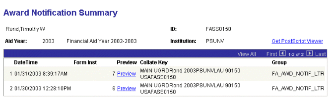

Viewing Award Notification Summary
Access the Award Notification Summary page (Financial Aid, and then Awards, and then Notification Letter, and then Award Notification Summary).
This example illustrates the fields and controls on the Award Notification Summary page. You can find definitions for the fields and controls later on this page.
To use the preview link, you must load the Get Post Script Viewer program. This program is freeware. You must load the GSVIEW and the GNU GHOSTSCIPT programs from this link.
This page is view only. It is intended for front-line users with limited access or security.
Click the Preview link to view and reprint a copy of the FE FAN letter associated with the Form Instance number.
