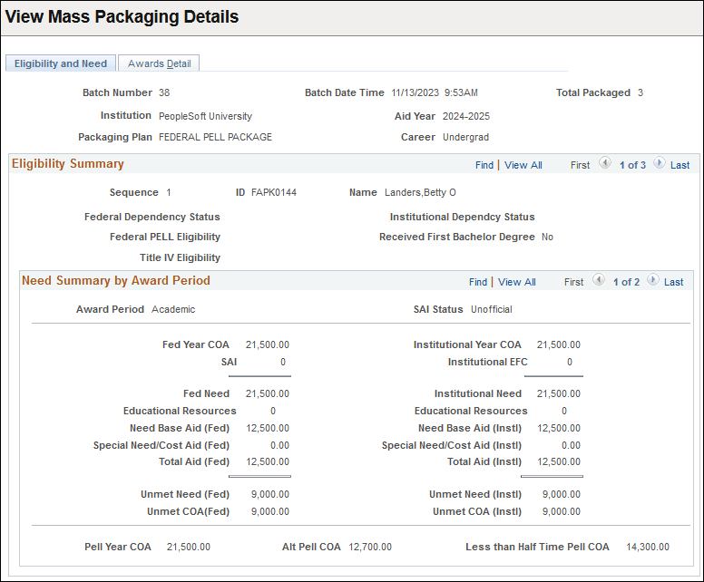

Reviewing Student Eligibility and Need Information
Access the Eligibility/Need page (Financial Aid, and then Awards, and then Mass Packaging, and then View Mass Packaging Details, and then Eligibility/Need).
This example illustrates the fields and controls on the Eligibility/Need page. You can find definitions for the fields and controls later on this page.
This page displays information for a single packaging plan. To see other students packaged using the selected packaging plan, use the top set of scroll arrows. Use the bottom set of scroll arrows to view the information for each student by award period.
Field or Control Description
Sequence
The sequence number indicates the order in which students were packaged during Mass Packaging.
Federal Dependency Status
Indicates whether the student is dependent or independent under federal methodology.
Institutional Dependency Status
Indicates whether the student is dependent or independent under institutional methodology.
Federal Pell Eligibility
Indicates whether the student is eligible to receive a Pell Grant.
Received First Bachelor Degree
Indicates whether the student has already received his or her first bachelor's degree.
Title IV Eligibility
Indicates whether the student is eligible to receive federal Title IV aid.

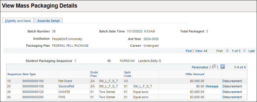

Reviewing Student Award Information
Access the Awards Detail page (Financial Aid, and then Awards, and then Mass Packaging, and then View Mass Packaging Details, and then Awards Detail).
This example illustrates the fields and controls on the Awards Detail page. You can find definitions for the fields and controls later on this page.
Awards Detail page
All awards in the packaging plan are displayed for each student. The page displays zero and nonzero awards—nonzero awards display the scheduled disbursements.
Student Packaging Sequence
Sequence
The sequence number automatically assigned in increments of ten when awards are entered.
Item Type
The financial aid item type of the student's award.
Disbursement Plan
The disbursement plan assigned to the student's award.
Split Code
The split code of the student's award, which indicates how the award is split for disbursement to the student.
Offer Amount
If the Offer Amount for an award is 0.00, then the student was not eligible for that particular award or it was an unlocked, preexisting award which was set to 0.00 by Mass Packaging. The awards with a zero Offer Amount are no longer visible after the student's award package is posted.
Message
Click to access the Mass Packaging Award Message page and view the reason why the student did not receive this award.
Disbursement
Click to access the Mass Packaging Disbursement page and view scheduled disbursement detail for an award.
