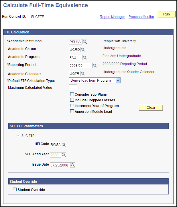

Access the Calculate Full-Time Equivalence page (Financial Aid, and then Student Loans Company, and then Calculate FTE, and then Calculate SLC FTE).
This example illustrates the fields and controls on the Calculate Full-Time Equivalence page. You can find definitions for the fields and controls later on this page.

In the SCL FTE Parameters group box, all 3 parameters, HEI Code, SLC Acad Year, and Issue Date are required.
