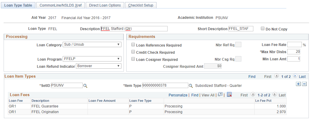

Defining Loan Types
Access the Loan Type Table page (Set Up SACR, and then Product Related, and then Financial Aid, and then Loans, and then Create Loan Types, and then Loan Type Table).
This example illustrates the fields and controls on the Loan Type Table page. You can find definitions for the fields and controls later on this page.
When you set up a loan financial aid item type, you include specific conditions for processing the loan. You must complete the Loan Type Table page to complete the setup.
Field or Control Description
Do Not Copy
Select this option to prevent the Loan Type from being copied during the Aid Year Rollover process.
Processing
Loan Category
Select from Alt Loan (alternative loan), PLUS, Sub/Unsub (subsidized/unsubsidized), Subsidized, and Unsubsidized. If you select PLUS, a Graduate PLUS Indicator check box displays. Select the check box for Grad PLUS loans.
Loan Program
Select from Alternative, Direct, FFELP, Health, Perkins, State, and University.
For example, to set up Stafford loans processed through CommonLine, you might specify the loan category as Sub/Unsub and the loan program as FFELP. To set up an alternative loan program processed through CommonLine, specify the loan category as Alt Loan (alternative loan), and the loan program as Alternative.
Loan Refund Indicator
Select from:
Borrower: Select to have the borrower of the loan receive any refunds or overage. For example, the borrower would be a parent or guardian for a PLUS loan.
Student: Select to have the student to receive any refunds from the loan.
You can override this field at the loan application level. Note that additional setup is required in Student Financials to generate refunds to the proper recipient.
Requirements
The system enforces the selected requirements during loan validation when utilizing the corresponding loan edit.
Loan References Required
Enter reference information on the Promissory Note Plus and Promissory Note Alt pages and Loan Origination components (SFA_CRC_ORIG). Enter the number of references required in the Nbr Ref Rq (number of references required) field.
Loan Cosigner Required
If you select this check box, enter the number of cosigners required in the Nbr Csg Rq (number cosigners required) field.
Cosigner Required Amount
Enter the minimum loan amount that requires a cosigner. Enter cosigner information on the Promissory Note Plus and Promissory Note Alt pages and Loan Origination components (SFA_CRC_ORIG). Note that this requirement is enforced by the loan servicer and not the loan validation process.
Loan Fee Rate
Enter the loan fee rate to print on the promissory note for this loan type. Ensure that the loan fee rate matches the loan fee setup for the item type that you associate with this loan type.
Loan Item Types
SetID
Select a setID and an item type. You can associate multiple item types with the same loan type. You cannot share item types across multiple loan types. For example, to define FFELP Stafford loans, enter the subsidized and unsubsidized item types.
Based on the business processes defined by your institution, you might need to create multiple loan types for the same loan program.
The system displays the loan fee, description, loan fee amount, loan fee type, and loan fee percent for the item type selected. These values are associated with the item type when you set up the financial aid item type on the Loan Fee Table page.
