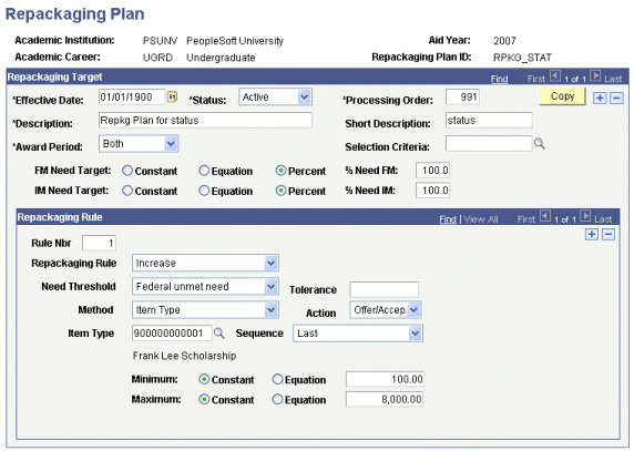

Access the Repackaging Plan page.
This example illustrates the Repackaging Plan page (Increase rule).
Example of the Repackaging Plan page (Increase rule)
This example shows a repackaging plan setup to award an additional amount of 8,000 USD, using the Frank Lee Scholarship item type, with an award action of Offer/Accept.

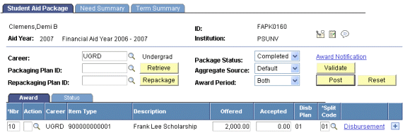

Access the Student Aid Package page.
This example illustrates the Student Aid Package page with an award in Offered status.
Example of the Student Aid Package page with an award in Offered status
This example shows that the student has an existing award (Frank Lee Scholarship) for 2,000 USD in Offered status.

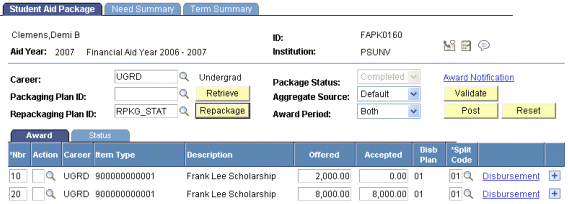

This example illustrates the Student Aid Package page after Repackaging.
Example of the Student Aid Package page after Repackaging
This example shows that the repackaging plan has awarded the student a second instance of the Frank Lee Scholarship for an additional amount of 8,000 USD.

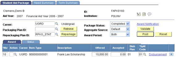

This example illustrates the Student Aid Package page with the combined award after posting.
Example of the Student Aid Package page with the combined award after posting
When you post the awards, the system combines the two instances of the Frank Lee Scholarship item type into a single award of 10,000 USD.
The system sets the final award action to Offered status because the first instance of the Frank Lee Scholarship was in Offered status.
