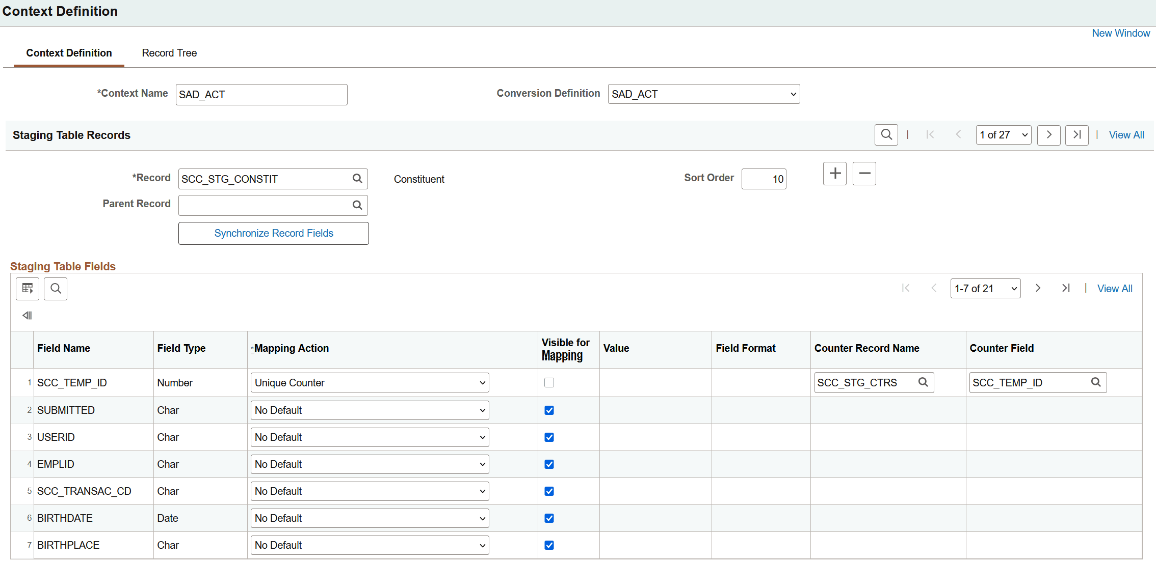

Use the Context Definition page to add the delivered staging tables as well as any additional extension staging tables that need to be updated when loading data from the external file. You may have created the extension tables by performing steps listed in this section of the Developer Reference for Creating a New CTM Consumer documentation:
Campus Community Fundamentals: Step 1: Creating or Extending Staging Tables
Ensure that you enter the correct Parent Record field value. For bulk load of admission applications, SCC_STG_CONSTIT must be the first record entered as it is the parent to all records.
This example illustrates the Context Definition page.
Example of a context definition
For bulk load of admission applications, the counters that you must include in the context definition are:
  • SCC_TEMP_ID: SCC_STG_CTRS.SCC_TEMP_ID
  • ADM_APPL_NBR: INSTALLATION_SA.ADM_APPL_NBR_LAST
The unique counter for ADM_APPL_NBR must be set up in the context definition and the Visible for Mapping should be deselected for the ADM_APPL_NBR field.

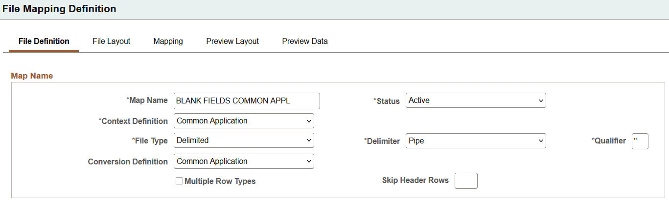

Use the File Definition page to provide information about the external file.
This example illustrates the File Definition page.
Example of a file definition
Field or Control Description
Skip Header Rows
This field is enabled only when the Multiple Row Types checkbox isn’t selected.
Enter a value if the external file has header rows that should be ignored when loading to the staging records.

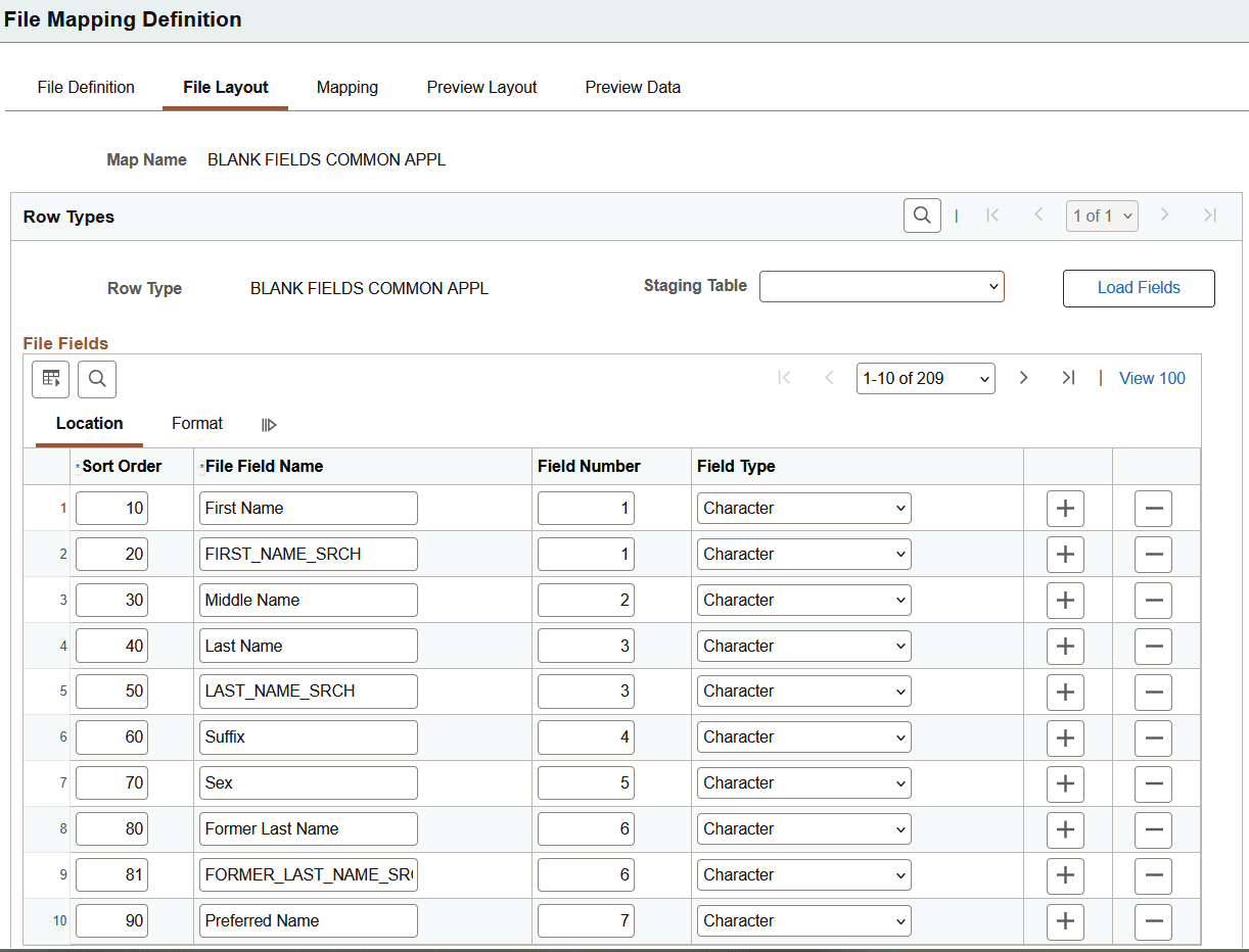

Use the File Layout page to define fields from the external file that will be loaded into the staging tables.
This example illustrates the File Layout page.
Example of a file layout

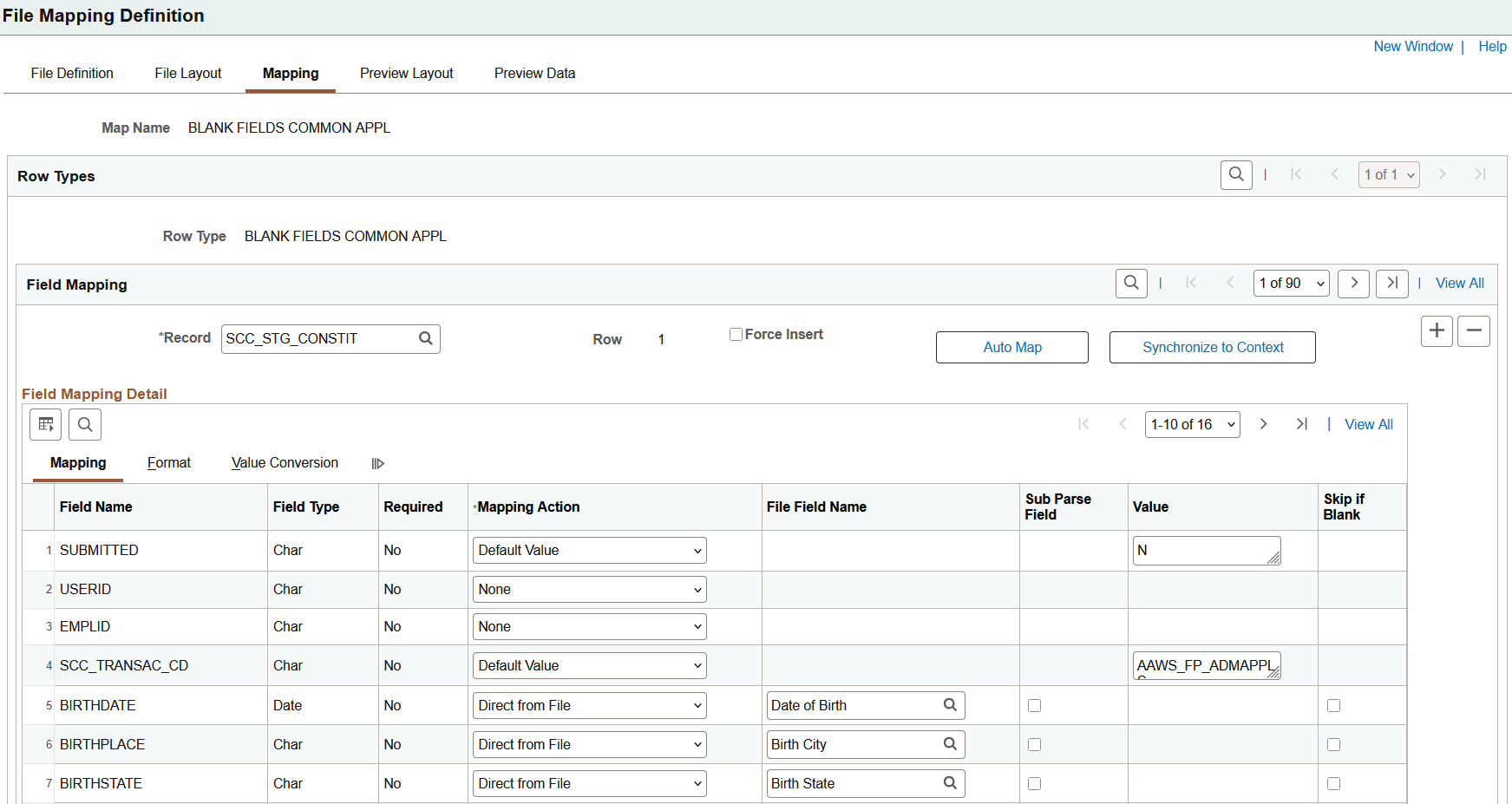

Use the Mapping page to associate fields defined on the File Layout page with staging table fields defined in the context definition.
This example illustrates the Mapping page.
Example of a mapping
There could be required description fields that may require a calculated field to populate. File Parser does not populate the description based on the code populated. You must build a calculated field to load a description. Examples of required description fields:
  • Academic Interests - SCC_STG_ADMINT. DESCR
  • Extracurricular Activities - SCC_STG_EXTRACU.DESCR
  • External Degrees - SCC_STG_EXTDEGR.DESCR
SAD_APL_PRG_STG.APPL_PROG_NBR: To have the system automatically set the Application Program Number to zero (which is the default when adding a new application), set the Mapping Action for this field to a Default Value of 0. If you are inserting multiple program rows for one application number, set the second occurrence of this field to a Default Value of 1.

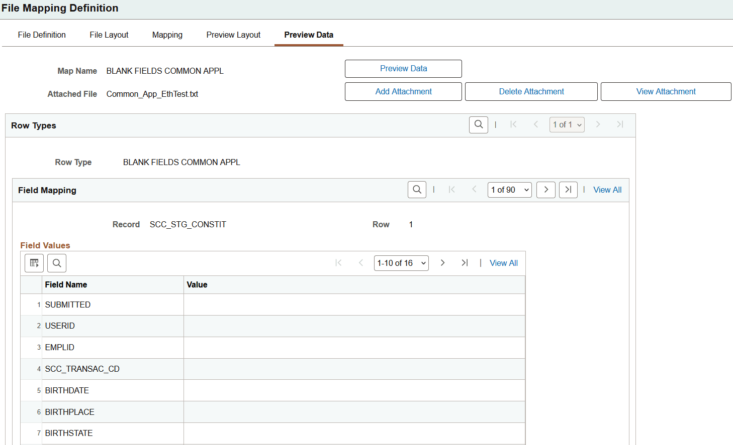

Use the Preview Data page to test your external file with the File Parser Definitions.
The preview feature shows only the first row of each row type; therefore, you should use a small test file when using this component. Using a large test file is simply a waste of resources that could potentially degrade the application server.
When you click Preview Data, the value in Skip Header Rows is considered. If Skip Header Rows is greater than zero, the defined number of rows are skipped when populating Field Mapping.
This example illustrates the Preview Data page.
Example of previewing data
