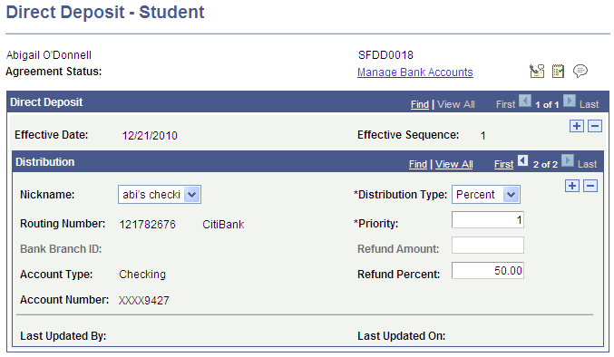

Access the Direct Deposit - Student page (Student Financials, and then Refunds, and then AP Direct Deposit, and then Direct Deposit - Student, and then Direct Deposit - Student).
This example illustrates the fields and controls on the Direct Deposit - Student page. You can find definitions for the fields and controls later on this page.

Distribution
Field or Control Description
Nickname
The Nickname field on the Bank Accounts page is optional.
If you enter a value in the Nickname field on the Bank Accounts page, that nickname, followed by the last 4 digits of the account number, appears here in the Nickname field on the Direct Deposit page. If you do not enter a Nickname value on the Bank Accounts page, the last 4 digits of the account number appear here in the Nickname field.
The values available here are for active bank accounts only.
When you select the nickname or the last 4 digits, the Routing Number, Account Type, and Account Number fields are automatically populated with the relevant account information from the Bank Accounts page.
Note: Only one distribution per bank account (nickname) is allowed.
Distribution Type
When you set up the first distribution, a value of Balance appears in this field by default and cannot be changed. You must always assign the distribution type of Balance to one account.
The other distribution type values are Percent and Amount.
If refunds are to be distributed across more than one account, you can assign a Balance distribution type to only one of those accounts.
Priority
If the distribution type is Balance, a value of 999 appears in this field by default and cannot be changed.
The value that you enter here indicates the order in which a bank account is selected to post a refund. The lower the number, the higher the priority—for example, an account with a value 1 is used first, then an account with a value 2.
You can enter only whole numbers—for example, 1.5 is not allowed.
Refund Amount
This field is available only if the distribution type is Amount.
Currency code appears based on the value set up in the Common Objects component (Set Up Common Objects, and then Foundation Tables, and then Currency and Market Rates, and then Currency Code).
Refund Percent
This field is available only if the distribution type is Percent.
