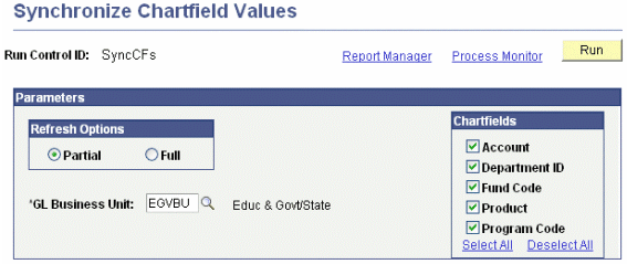

This example illustrates the fields and controls on the Synchronize Chartfield Values page. You can find definitions for the fields and controls later on this page.
To use this batch process, ensure that you have selected the Oracle Financials check box in the Financial System group box on the SF Installation page.
Refresh Options
Field or Control Description
Partial
This option is selected by default. Use this option to run an incremental update of the prompt tables. Student Financials data is updated only if there has been a change to Oracle GL data since the last time that the process was run.
Full
Select this option to run a complete refresh of the prompt tables.
You would usually select this option for first time installation only.
Note: If you select the Full option, all prompt tables except the Department Chartfield (DEPT_TBL) prompt table are truncated and existing data is purged before the full synchronization happens. The Department Chartfield prompt table is not truncated. Unlike other chartfield prompt tables that are truncated based on an inactive status of chartfields on the Standard Chartfield Configuration page (Set Up Common Objects, and then Common Definitions, and then Chartfield Configuration, and then Standard Configuration), new values are added to the Department Chartfield table and the existing values remain intact.
