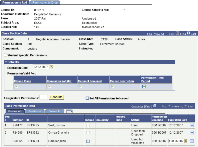

Creating Add Permissions for Classes
Access the Permission to Add page (Records and Enrollment, and then Term Processing, and then Class Permissions, and then Class Permissions, and then Permission to Add).
This example illustrates the fields and controls on the Permission to Add page. You can find definitions for the fields and controls later on this page.
Field or Control Description
Student Specific Permissions
The status of this check box defaults from the Basic Data page.
Permission Time Period
Select this check box to allow a student to enroll in the class during the enroll with permission time period. This time period is determined by a user's enrollment security access ID and by the time period end dates that are defined in the Session Time Period table.
See Campus Solutions Application Fundamentals: Setting Up Enrollment Access IDs.
SeeCampus Solutions Application Fundamentals: Defining Terms, Sessions, and Session Time Periods
The Permission Valid For check boxes are used to specify the conditions that a class permission overrides:
Closed Class
Select to allow students to enroll in a class that is full. This type of permission also allows students to enroll in a closed combined section, or in a class where all available seats are subject to reserve capacity requirements that they might not meet.
Requisites Not Met
Select to allow students to enroll in a class for which they do not meet the prerequisites.
Consent Required
Select to allow students to enroll in a class that requires instructor or department consent to add, as indicated by the Add Consent field on the Enrollment Cntrl page.
Career Restriction
Select to allow students to enroll in a class that is outside their career.
Select to allow students to enroll in a class during the enroll with permission time period. This time period is determined by a user's enrollment security access ID and by the time period end dates that are defined in the Session Time Period table.
Assign More Permissions
This field is available only if the Student Specific Permissions check box is not selected. Enter the number of permissions you want to create. When you click Generate, the requested number of rows appear in the Class Permission Data group box.
Set All Permissions to Issued
If you select this check box, all the cleared Issued check boxes in the Class Permission Data group box are selected. The Issued By and Issued Date fields are populated when you save the page.
The information that appears in this group box changes, depending on whether you create student-specific or general add permissions.
General Info
Select the General Info (general information) tab.
Number
The value that appears is a random number generated for general class permissions.
ID
For student-specific permissions, enter the ID for which you want to create the permission. For general class permissions, this field is populated with the student's ID when the student successfully uses the add permission. When the permission is used, the field is display only.
Issued
Select this check box to indicate that a general permission has been issued to a student. Select the Set all Permissions to Issued check box to select the check boxes in all rows.
If the Issued check box is selected, these fields are populated when you save the page. The system displays the operator's user ID in the Issued By field.
Status
View the status of the permission. Values include:
Used but Wait Listed: Appears when a student is placed on the wait list for a class for which the student has a permission number or student specific permission. The wait list process can therefore use the permission number or student specific permission to allow the student to enroll, without meeting conditions such as requisites.
Used: In the example of a student who is placed on the wait list for a class, this value appears when the student is moved from the wait list and enrolled in the class.
Used then Dropped: Appears when a student uses a permission to add a class and subsequently drops the class.
Permission
Select the Permission tab.
The permission conditions, such as Closed Class, default to the values selected in the Defaults group box. You can select different values for each permission row. When the permission is used, the check boxes become unavailable.

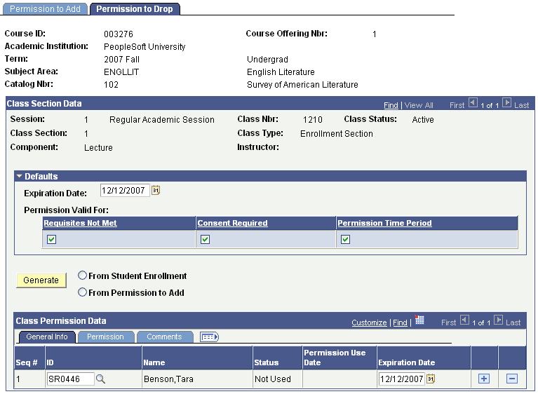

Creating Drop Permissions for Classes
Access the Permission to Drop page (Records and Enrollment, and then Term Processing, and then Class Permissions, and then Class Permissions, and then Permission to Drop).
This example illustrates the fields and controls on the Permission to Drop page. You can find definitions for the fields and controls later on this page.
Drop permissions can be used even if the class does not use add permissions. Drop permissions are always student specific.
You can create drop permissions on a student-specific basis only.
Requisites Not Met
Select to allow students to drop a class even if it is being used as a corequisite for another class. For example, a student is enrolled in Class A and Class B. Class B requires concurrent enrollment in Class A. If the Requisites Not Met check box is selected, the student can drop Class A without also dropping Class B.
Consent Required
Select to allow students to drop a class where instructor or department consent is required to drop, as indicated by the Drop Consent field on the Enrollment Cntrl page.
Select to allow students to drop a class during the drop with permission session time period. This time period is determined by a user's enrollment security access ID and by the time period end dates that are defined in the Session Time Period table.
Note: The drop permission has no impact on the consequence of the drop, for example, drop without penalty. This is still determined by the academic calendar dates.
From Student Enrollment
Click this button, and then click Generate to create drop permissions for students who are enrolled in the class. You receive an error message if no eligible rows exist.
From Permission to Add
Click this button, and then click Generate to create drop permissions for students who have been granted add permissions on the Permission to Add page. You receive an error message if no eligible rows exist. Eligible rows only exist if add permissions were created on a student-specific basis. Rows are generated whether or not the student has enrolled in the class.
View and update details and add comments for drop permissions.
General Info
Select the General Info tab.
ID
Enter the ID for which you want to create a drop permission. When the permission is used, the field becomes unavailable for edit.
Status
View the status of the permission. Values are Used and Not Used.
Permission
This example illustrates the fields and controls on the Permission to Drop page: Permission tab. You can find definitions for the fields and controls later on this page.
The permission conditions, such as Requisites Not Met, default to the values selected in the Defaults group box. You can select different values for each permission row. When the permission is used, the check boxes become unavailable.
