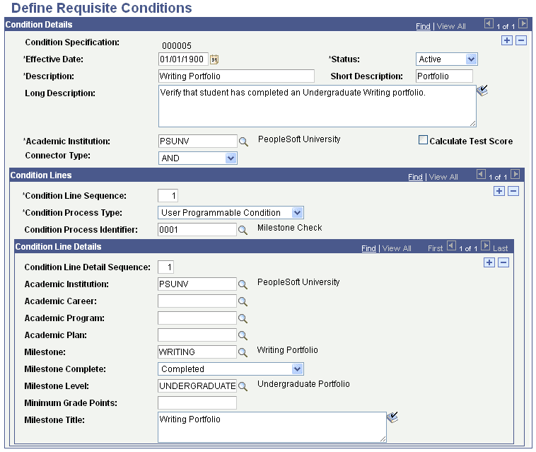

Access the Define Requisite Conditions page (Curriculum Management, and then Enrollment Requirements, and then Define Requisite Conditions, and then Define Requisite Conditions).
This example illustrates the fields and controls on the Define Requisite Conditions page (in Add mode). You can find definitions for the fields and controls later on this page.

The system prompts you with values based on your selections in the Condition Code and Condition Operator fields.

Milestone
Enter the milestone that must be achieved to satisfy this condition line detail. For example, a milestone could be an audition, qualifying exam, or thesis. You define milestones in the Milestone table.
Milestone Complete
Select the appropriate milestone. Values are:
None: Indicates that the field is not applicable.
Completed: Indicates that the student must complete this milestone to satisfy the condition line detail.
In Progress: Indicates that the student must be working towards completing the milestone to satisfy the condition line detail.
Not Completed: Indicates that the student must not have completed this milestone to satisfy the condition line detail.
Milestone Level
Enter the minimum level for this milestone. Some examples of milestone levels are honors, undergraduate, or graduate.
Minimum Grade Points
Enter the minimum grade points that are acceptable to complete this condition line detail.
Milestone Title
Enter a descriptive phase as the milestone title. Use this field for documentation purposes only.
If the condition process type is User Programmable Condition and the condition process identifier selected is External Degree Check or Internal Degree Check, the user then must select a degree.
Field or Control Description
Degree
Enter the degree that must be obtained to satisfy the condition line.
