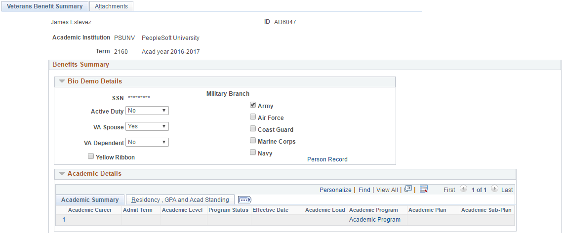

Access the Veterans Benefit Summary page (Records and Enrollment, and then Enrollment Reporting, and then Veterans Benefit Reporting, and then Veterans Benefit Summary).
This example illustrates the fields and controls on the Veterans Benefit Summary page (1 of 2). You can find definitions for the fields and controls later on this page.
This example illustrates the fields and controls on the Veterans Benefit Summary page (2 of 2). You can find definitions for the fields and controls later on this page.
Bio Demo Details
Enter or update the student's biographical details.
For information on how to mask the social security number:
See Campus Solutions Application Fundamentals: Applying Demographic Data Access Security
For information about service indicators:
See Campus Community Fundamentals: Setting Up Service Indicator Codes and Reasons
Field or Control Description
Yellow Ribbon
Select this check box if the student is enrolled in the Yellow Ribbon program. If the check box is selected, the system displays the Yellow Ribbon section on the Tuition Worksheet.
Person Record
Select this link to access the student's biographical and demographic data.
Use the Addresses page to indicate the address to which the Veterans Benefit check is to be sent. The Veterans Administration verifies that the recipient's address they have matches the address that your institution indicates.

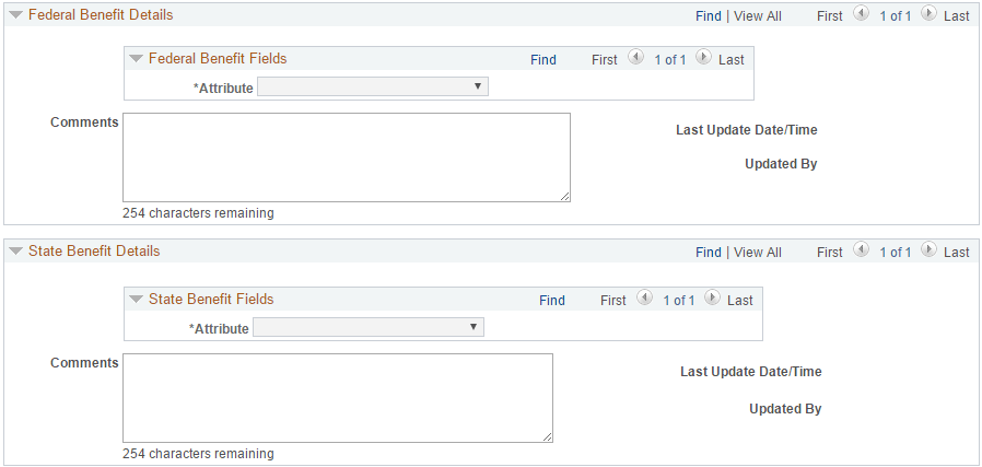

Federal Benefit Details and State Benefit Details
The attributes available here are those that you define on the Common Attribute page (Set Up SACR, Common Definitions, Common Attributes Setup, Common Attribute).
After you define attributes, associate attributes with a record context on the Record Context page (Set Up SACR, Common Definitions, Common Attributes Setup, Record Context).
The delivered record contexts are SSR_VB_FED_AUD and SSR_VB_STA_AUD.
See Campus Community Fundamentals: Understanding Common Attribute Framework
See Campus Community Fundamentals: Defining a Common Attribute
