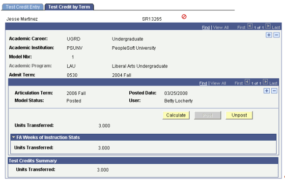

Calculating and Posting Test Transfer Credit with Predefined Rules
Access the Test Credit by Term page (Records and Enrollment, and then Transfer Credit Evaluation, and then Test Credits - Automated, and then Test Credit by Term).
This example illustrates the fields and controls on the Test Credit by Term page . You can find definitions for the fields and controls later on this page.
The units of the internal equivalent course appear in the Units Transferred field in the FA Weeks of Instruction Stats (financial aid weeks of instruction statistics) group box.

Calculating and Posting Test Transfer Credit Manually
Access the Test Credit by Term page (Records and Enrollment, and then Transfer Credit Evaluation, and then Test Credits - Manual, and then Test Credit by Term).
The Test Credit by Term page in the Test Credits - Manual component is the same page as the Test Credits By Term page in the Test Credits Component.

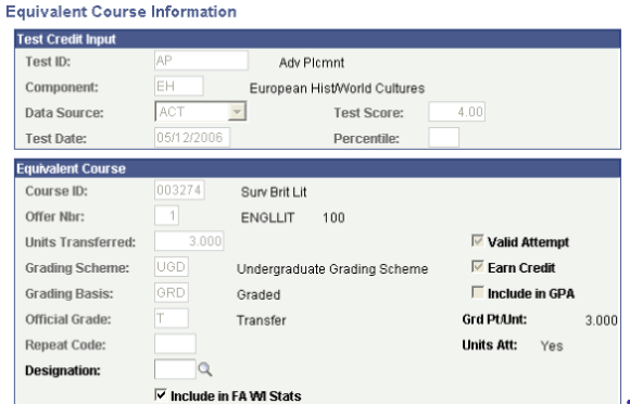

Entering Incoming Test and Equivalent Course Information
Access the Equivalent Course Information page (click the Edit Equivalent Course button on the Test Credit Entry page).
This example illustrates the fields and controls on the Equivalent Course Information page . You can find definitions for the fields and controls later on this page.
Test Credit Input
Use the Test Credit Input group box to enter test information.
Field or Control Description
Test ID
The identification number of the test for which you are defining a course equivalency.
Component
The component of the test for which you are defining a course equivalency.
Test Date
The date that the test was taken.
Test Score
The individual's test score.
Data Source
The data source.
Percentile
The percentile of the individual's score.
Equivalent Course
Use the Equivalent Course group box to enter internal equivalent course information.
