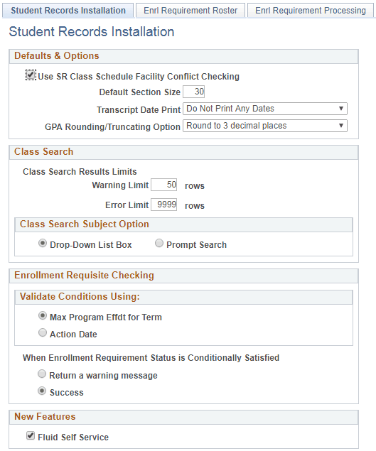

Reviewing or Defining Default Installation Settings
Access the Student Records Installation page (Set Up SACR, and then Install, and then Student Records Installation).
This example illustrates the fields and controls on the Student Records Installation page. You can find definitions for the fields and controls later on this page.
Defaults & Options
Field or Control Description
Use SR Class Schedule Facility Conflict Checking
Select to enable facility conflict checking when scheduling classes. The check box value migrates from the Installation page to the Academic Institution 2 page to the Campus Table page. The system uses the value on the Campus Table page during processing. Clear this check box on the Campus Table page to use an external facility conflict checking process.
Note: This check box has no relation to the Check for Facility Conflict check box on the Facility Table page, which controls whether you can schedule multiple events in the same facility.
Default Section Size
Enter a number to use as a default for class size. This value is used in the creation of new class sections. The value is originally rolled into the Catalog record when it is created, and then it is used to enter the number by default into the ENRL_CAP field in the CLASS_TBL.
Transcript Date Print
Select the date on which you want the system to print when printing student transcripts. Select a value to be the default value when a row is entered. Select one value per term. Values are:
Print Class Dates: Prints the valid start and end dates for each class on a transcript.
Print Session Dates: Prints the valid start and end dates for a session within a term on a transcript.
Print Term Dates: Prints the valid start and end dates for the term on a transcript.
Do Not Print Any Dates: No dates print on the transcript.
GPA Rounding/Truncating Option (grade point average rounding/truncating option)
Enter a value to indicate the number of decimal places to which you want to round or truncate the grade point average displayed for a student throughout the system. The maximum allowed is three decimal places.
Class Search
Class Search Results Limits
Enter a value in the Warning Limit and Error Limit fields to indicate the number of classes for the system to display when a student searches for a class.
  • Warning Limit: When the limit is reached, the student receives a Warning message. The student can continue to the search results or cancel and add additional criteria to narrow the search.
  • Error Limit: When the limit is reached, the student receives an Error message requesting that the student specify additional search criteria.
Class Search Subject Option
Select to indicate whether the Course Subject field on the Search for Classes page appears as a drop-down list box or as a select subject button.
Note: Regardless of the option setting, the Course Subject field dynamically changes to a select subject button if the selected institution has more than 300 course subjects.
Enrollment Requisite Checking
Use this group box to select how the requisite checking process validates programs, plans, and subplans for requisites that specify program, plan, or subplan conditions—for example, if a student enrolls in a class for a term and the class has a requisite condition of Plan = BIOCHEM, what is the maximum effective date that a plan of BIOCHEM can have to meet the requisite for that term.
Validate Conditions Using:
Max Prog Effdt for Term (maximum program effective date for term)
This option is selected by default.
The requisite checking process uses the following logic to establish if a student meets program, plan, or subplan conditions:
  • If the enrollment action date is before or equal to the term begin date, use the term begin date to determine the program, plan, or subplan: Find the maximum effective-dated row, where the effective date is before or equal to the term begin date.
    For example, on 05/30/07 a student tries to enroll in a Fall 2007 class that has a requisite condition of the LAU program. Fall 2007 commences on 08/30/07. The student's current program is FAU (with an effective date of 01/01/06), but the student has a future-dated program change of 07/01/07 for the LAU program. The student meets the requisite condition because the maximum effective-dated program row (which is before or equal to the term begin date) is for the LAU program.
  • If the enrollment action date is after the term begin date and before or equal to the maximum program effective date for Term, use the action date to determine the program, plan, and subplan: Find the maximum effective-dated row where the effective date is before or equal to the enrollment action date.
    For example, on 09/05/07, a student tries to enroll in a Fall 2007 class that has a requisite condition of the LAU program. The student transferred to the LAU program effective 09/02/07. Fall 2007 commences on 08/30/2007 but has a maximum effective for term of 09/14/07. The student therefore meets the requisite condition.
  • If the enrollment action date is after the maximum program effective date for term, use the maximum program effective date for term to determine the program, plan, or subplan: Find the maximum effective-dated row where the effective date is before or equal to the maximum program effective date for term.
    For example, on 09/17/07, a student tries to enroll in a Fall 2007 class that has a requisite condition of the LAU program. Fall 2007 commences on 08/30/07 but has a maximum program effective date for term of 09/14/07. The student transferred to the LAU program effective 09/15/07. The student does not meet the requisite condition, because FAU, not LAU is the program for which the maximum effective date is before or equal to the maximum effective date for term.
Action Date
The requisite checking process uses the enrollment action date instead of the maximum program effective date for term when the term begin date is reached:
  • If the enrollment action date is before or equal to the term begin date, the process uses the same logic as when the Max Program Effdt for Term option is selected.
  • If the enrollment action date is after the term begin date, use the enrollment action date to determine program, plan, or subplan: Find the maximum effective-date row where the effective date is before or equal to the enrollment action date.
    For example, on 09/17/07, a student tries to enroll in a Fall 2007 class that has a requisite condition of the LAU program. Fall 2007 commences on 08/30/07 but has a maximum program effective date for term of 09/14/07. The student transferred to the LAU program effective 09/15/07. The student meets the requisite condition because LAU is the program for which the maximum effective date row is before or equal to the enrollment action date.
When Enrollment Requirement Status is Conditionally Satisfied:
Return a warning message
When requisite checking uses in-progress courses to satisfy an enrollment requirement, the user receives a warning message indicating that the prerequisite has been met conditionally and that the prerequisite must be satisfied prior to the start of the class.
Success
This option is selected by default. When requisite checking uses in-progress courses to satisfy an enrollment requirement, a message of success is returned.
See Understanding Enrollment Requisite Setup and Maintenance

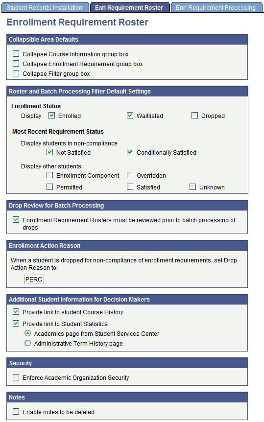

Access the Enrollment Requirement Roster page (Set Up SACR, and then Install, and then Student Records Installation, and then Enrollment Requirement Roster).
This example illustrates the fields and controls on the Enrollment Requirement Roster page. You can find definitions for the fields and controls later on this page.
Find documentation about the pages that are used to run Post Enrollment Requirement Checking—the Enrollment Requirement Roster page and the Run Post Enrollment Requirement Checking page—in the Post Enrollment Requirement Checking topics.
Collapsible Area Defaults
Collapse Course Information group box, Collapse Enrollment Requirement group box, and Collapse Filter group box
Clear these check boxes if you want course information, enrollment requirement description, and enrollment requirement roster filter to appear expanded by default on the Enrollment Requirement Roster. Select if you want the fields to appear collapsed.
Regardless of this setup, you can expand and collapse the fields on the Enrollment Requirement Roster.
Roster and Batch Processing Filter Default Settings
Enrollment Status
Select the enrollment statuses that you want to appear by default in the Set Filter Options group box on the Enrollment Requirement Roster. You can override the values on that page.
Most Recent Requirement Status: Display Students in non-compliance
Select the enrollment requirement non-compliance statuses that you want to appear by default on the Enrollment Requirement Roster. You can override the values on that page.
Most Recent Requirement Status: Display other students
Select any additional enrollment requirement statuses you want to appear by default on the Enrollment Requirement Roster. You can override the values on that page.
Drop Review for Batch Processing
Enrollment Requirement Rosters must be reviewed prior to batch processing of drops
Select this check box to ensure that an enrollment requirement roster is set to Review Complete before batch drop processing occurs. The Review Complete for Batch Drop Processing check box appears on the Enrollment Requirement Roster and the following message appears on the Process Drop Requests for Post Enrollment Requirements batch processing page: Drops are only processed for classes where Drop Review is set to Complete.
Clear this check box if you do not use batch processing of drops or if you do not want to ensure that the enrollment requirement roster is reviewed before batch dropping students for non-compliance. The Review Complete for Batch Drop Processing check box is not available on the Enrollment Requirement Roster and the message does not appear on the batch drop processing page.
Enrollment Action Reason
When a student is dropped for non-compliance of enrollment requirements, set Drop Action Reason to
Define a default drop action reason code value to be used when a student is dropped for non-compliance of enrollment requirements. The value action reason code of PERC is delivered but can be changed. The value should be unique. When a class is dropped using the action reason code of PERC, the enrollment record is retained regardless of the Academic Calendar date for the drop delete deadline.
Additional Student Information for Decision Makers
Provide link to student Course History
Select this check box to allow decision makers and other users to access student course history from a link on the Enrollment Requirement Roster (the Course History link on the Audit / Information Links tab). Clear the check box to hide the Course History link.
Provide link to Student Statistics
Select this check box to allow decision makers and other users to access student academic statistics from a link on the Enrollment Requirement Roster (the Statistics link on the Audit / Information Links tab). Select an option to identify whether the user links to the Academics page (recommended) as used in the Student Services Center or the Administrative Term History page. Clear the check box to hide the Statistics link.
Security
Enforce Academic Organization Security
Select this check box to enforce academic organization security within the Enrollment Requirement Roster and related processing.
Notes
Enable notes to be deleted
Select this check box to enable notes to be deleted from the Enrollment Requirement Roster: Tracking of Key Transactions & User Notes page. Clear to prevent notes from being deleted.

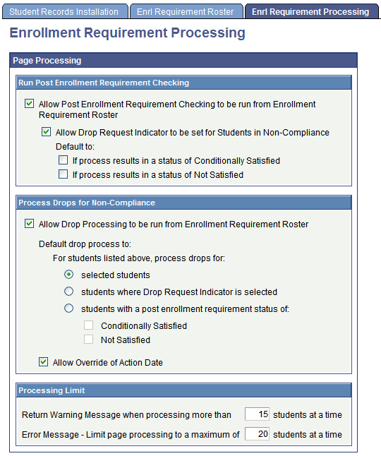

Reviewing or Defining Enrollment Requirement Processing Default Installation Settings
Find documentation about the pages that are used to run Post Enrollment Requirement Checking—the Enrollment Requirement Roster page and the Run Post Enrollment Requirement Checking page—in the Post Enrolment Requirement Checking topics.
Access the Enrollment Requirement Processing page ((Set Up SACR, and then Install, and then Student Records Installation, and then Enrollment Requirement Processing).
This example illustrates the fields and controls on the Enrollment Requirement Processing page (1 of 2). You can find definitions for the fields and controls later on this page.
This example illustrates the fields and controls on the Enrollment Requirement Processing page (2 of 2). You can find definitions for the fields and controls later on this page.
Use the Page Processing group box to select the information and values that you want to appear by default on the Enrollment Requirement Roster.
Page Processing: Run Post Enrollment Requirement Checking
Allow Post Enrollment Requirement Checking to be run from Enrollment Requirement Roster
Select this check box to allow users to run post enrollment requirement checking from the Enrollment Requirement Roster. If selected, the Run Post Enrollment Requirement Checking group box appears on the roster. If cleared, the group box is not available—users would instead run batch post enrollment requirement checking.
Allow Drop Request Indicator to be set for Students in Non-Compliance
If post enrollment requirement checking is enabled, select this check box to allow the Drop Request Indicator to be set from the Enrollment Requirement Roster processing page: If the check box is selected, the Set Drop Request for Students in Non-Compliance options appear in the Run Post Enrollment Requirement Checking group box on the roster. If the check box is cleared, the options are hidden.
Default to: If process results in a status of Conditionally Satisfied and Default to: If process results in a status of Not Satisfied
If you have selected the Allow Drop Request Indicator to be set for Students in Non-Compliance check box, use these check boxes to set the status default settings—Conditionally Satisfied and Not Satisfied—on the Enrollment Requirement Roster.
You can override the values on the Enrollment Requirement Roster.
Page Processing: Process Drops for Non-Compliance
The check boxes and values that are selected here appear by default on the Enrollment Requirement Roster but can be overridden on that page.
Allow Drop Processing to be run from Enrollment Requirement Roster
Select this check box to allow users to run drop processing from the Enrollment Requirement Roster. If selected, the Process Drops for Non-Compliance group box appears on the roster page. If cleared, the group box is not available—users would instead run batch drop processing.
Default drop process to:
If drop processing is enabled from the Enrollment Requirement Roster, define the default selection to:
  • selected students: The drop process is run only for selected students.
  • students where Drop Request Indicator is selected: The drop process is run only for students for whom the Drop Request Indicator value is selected.
  • students with a post enrollment requirement status of: The drop process is run only for students with a post enrollment requirement status of either Conditionally Satisfied or Not Satisfied. When this option is selected, the Conditionally Satisfied and Not Satisfied check boxes become available for selection.
Allow Override of Action Date
If drop processing is enabled from the Enrollment Requirement Roster, select this check box to allow a user to override the action date: the Override Action Date check box is available on the Enrollment Requirement Roster. The user must have enrollment security to override the action date.
Page Processing: Processing Limit
Return Warning Message when processing more than
Set the maximum number of students that can be selected for page processing before receiving a warning message. Our recommendation for a warning message is for 15 students—you therefore receive a warning message when 16 students or more are selected.
Error Message - Limit page processing to a maximum of
Set the maximum number of students that can be selected for page processing before receiving an error message. To assist with response time, use batch Post Enrollment Requirement Checking processing for large numbers of students. Our recommendation for an error message is for 20 students—you therefore receive an error message if 21 or more students are selected.
Batch Processing: Run Post Enrollment Requirement Checking
Select this check box to allow the Post Enrollment Requirement Checking batch process to set the Drop Request Indicator for a student when the process results in a non-compliant status. If you select this check box, the Action group box which contains the Set Drop Request Indicator for Students in Non-Compliance options is available on the Run Post Enrollment Requirement Checking page.
Use these check boxes to set the status default settings on the Run Post Enrollment Requirement Checking page: Conditionally Satisfied status and/or Not Satisfied.
You can override the values on the batch processing page.
Batch Processing: Process Drops for Non-Compliance
Default Non-Compliance Selection To
Process administrative student drops for students who are non-compliant with class enrollment requirements.
Process Drops for
Set the default options that you want to appear in the Non-Compliance Selection group box on the Process Drop Requests for Post Enrollment Requirement page:
  • students where Drop Request Indicator is selected: the process drops only students for whom the drop request indicator is selected.
  • students with a post enrollment requirement status of:When this option is selected, the Conditionally Satisfied and Not Satisfied check boxes become available for selection. The process drops only students that have a non-compliant post enrollment requirement status that matches the check box selection.
Select this check box to allow a user to override the action date for Process Drop requests: the Override Action Date check box is available on the Process Drop Requests for Post Enrollment Requirement page. The user must have enrollment security to override the action date.
