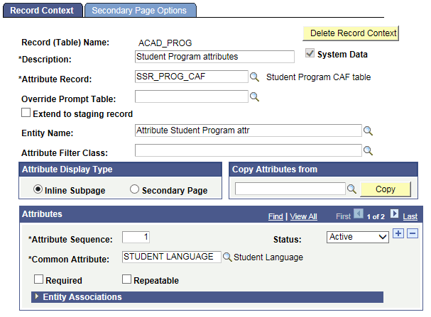

  1. Add the common attributes you want to use to associate students with specific classes.
    1. Go to Set Up SACR, and then Common Definitions, and then Common Attribute Setup, and then Record Context).
    2. In Record (Table) Name, make sure you select ACAD_PROG.
    3. In the Attributes region, specify the common attributes you want to use. The following images show examples of adding Student Language and Student Shift as the common attributes.
      This example illustrates adding common attribute "Student Language" to filter classes.
      Example 1: Adding common attribute "Student Language" to filter classes
      This example illustrates adding common attribute "Shift" to filter classes.
      Example 2: Adding common attribute "Shift" to filter classes
    4. Click Save.

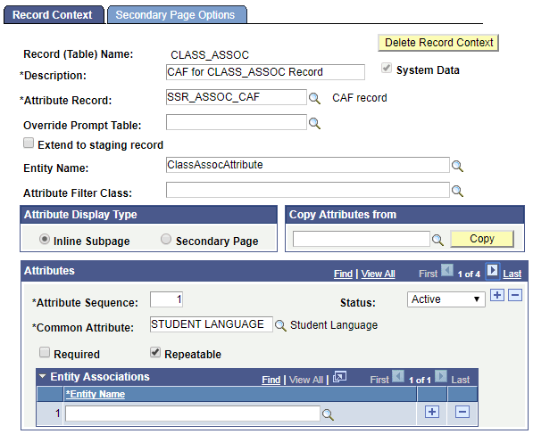

    5. Access the Record Context page again (Set Up SACR, and then Common Definitions, and then Common Attribute Setup, and then Record Context).
    6. In Record (Table) Name, select CLASS_ASSOC.
      This illustrates adding a common attribute to Record Name CLASS_ASSOC. You can find definitions for the fields and controls later on this page.
      Example 3: Adding common attribute to Record Name CLASS_ASSOC
    7. Add the same attributes you added to ACAD_PROG so that you can select these attributes on the Associated Class Attributes page (step 3), and then click Save.

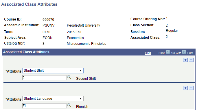

  3. Link the attribute to classes:
    1. Go to Curriculum Management, and then Schedule of Classes, and then Maintain Schedule of Classes.
    2. Click Associated Class Attributes.
    3. From the Associated Class Attributes region, add the attribute and assign a value.
      This illustrates how to linking common attributes to a class.
      Linking common attributes to a class
    4. When you are done adding attributes and assigning values, click OK.
    5. If there are other sections to which you want to link attributes, go to the next section in the list, then repeat steps b to d.
    6. Click Save.

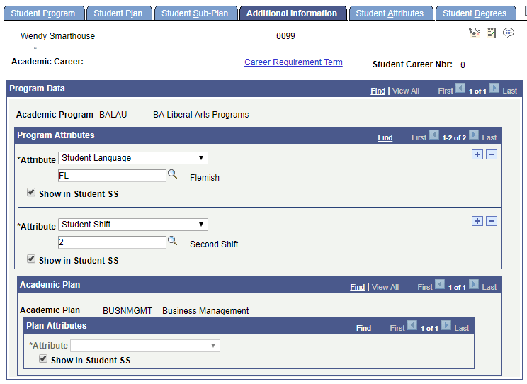

  4. Link the attributes and values to the student’s Program/Plan record.
    1. Go to Records and Enrollment, and then Career and Program Information, and then Student Program/Plan.
    2. Click Additional Information.
      This tab appears when you set up the attribute for the Record Name ACAD_PROG.
    3. In the Program Data region, add a program attribute and assign a value.
    4. Make sure you select Show in Student SS.
    This example shows program attributes set for Student Shift = 2, and Student Language = FL.
    This shows an example of linking common attributes to a student's program plan.
    Example of linking common attributes to a student's program plan
