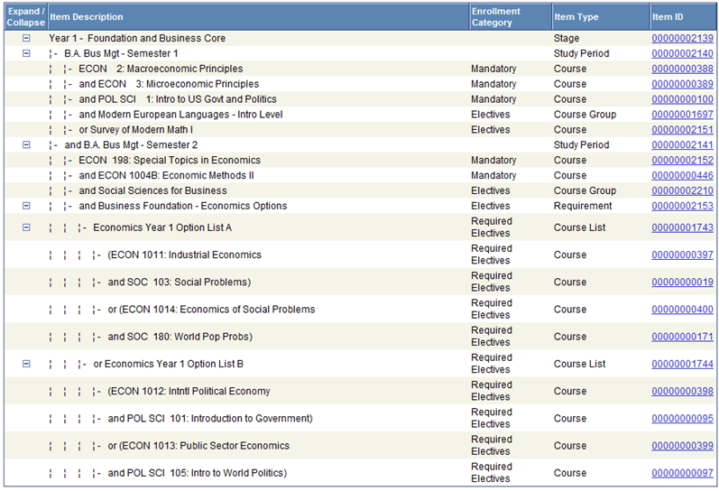

SSR_ACE - AIR Connector Engine:
This rule type is not tied to a Rules Engine Rule Group definition and does not invoke the Rules Engine, but rather serves as a hook to invoke the AIR Connector Engine API. This API validates a student’s course choices against the structure or ‘tree’ defined in the Academic Item Registry for a particular planning node.
The following example shows the program tree requirements for year one of a program. In this particular case, the Item Type Stage is a planning node for this program.
Program Tree Requirements example
To satisfy the course requirements for Year 1, students must satisfy the course requirements for each Study Period within the year, Semester 1 and Semester 2 as follows:
  • For Semester 1, students must have ECON 2 and ECON 3 and POL SCI 1 and select a course from the Modern Languages Course Group or select Survey of Modern Math.
  • For Semester 2, students must have ECON 198 and ECON 1004B and select a course from the Social Sciences Course Group and satisfy the Business Foundation options requirement.
  • For Business Foundation options, students must select one pair of courses from List A or List B.
  • To satisfy List A or List B student must select a matching pair of courses.
The Air Connector Engine (ACE) process traverses this tree and verifies that each of these requirements – as defined by the AND/OR connectors in AIR – have been met. If all items are not satisfied, an error message is returned.
Currently, ACE can be invoked on the student My Education Plan and Scheduler Builder components. (see Execution Event Rule Types below).

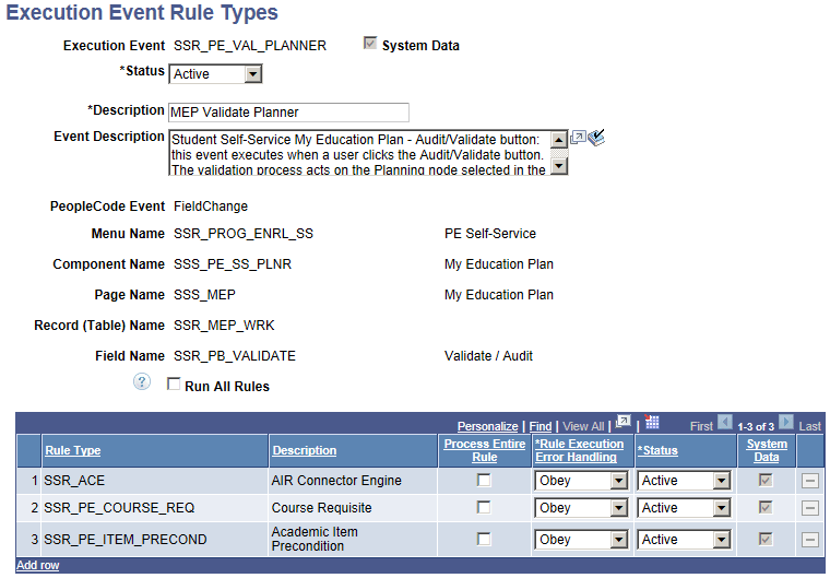

Associating Rule Types with Execution Events
Execution Event rule types determine how and when the Rules Engine is invoked in Program Enrollment, by tying rule types to a specific action that a user might take in the delivered User Interface. The PeopleCode event referenced in the Execution Event definition is a pointer to the code that invokes the Rules Engine when the action occurs, such as user a clicking a button in the User Interface. Each event in turn can invoke certain rule types, each of which can be set to active or inactive.
See the Using the Rules Engine for Program Enrollment Student Self-Service: System/Example Data document in My Oracle Support (ID 1400723.1).
Access the Program Enrollment - Execution Event Rule Types page (Set Up SACR, and then Product Related, and then Student Records, and then Program Enrollment, and then Execution Event Rule Types).
This example illustrates the fields and controls on the Program Enrollment - Execution Event Rule Types page. You can find definitions for the fields and controls later on this page.
Field or Control Description
System Data
This check box displays for Execution Event Rule Types definitions delivered by Campus Solutions Development. See further information below.
Status
Campus Solutions Development events are delivered as Inactive. Events must be Active for Rules Engine invocation to occur.
Copy
This button is available only when you add a new execution event. The copy feature provides a prompt against all execution events defined in the system, including those for which the System Data check box is selected. (see below).
Delete
When an execution event is saved successfully, a Delete button is available (Delete is not available for execution events for which the System Data check box is selected).
PeopleCode Event
Select a value: Field Change, Field Edit, Save Edit, or Save Pre-Change. The event selected here documents where the trigger PeopleCode that invokes the Rules Engine is called from by the component processor. In most cases, and specifically for the delivered self-service execution events, the PeopleCode event is Field Change.
Menu Name, Component Name, Page Name and Field Name
These fields are used to document the actual page/field location where the execution event occurs.
Run All Rules
When this check box is deselected, rule execution stops when the first error is encountered. For example, if a student adds three courses to their planner in self-service and each of those courses has a Course Requisite rule attached to them, and the student fails the first requisite, an error is returned for the first requisite but the other two requisite rules are not checked. If the Run All Rules check box is selected, all three rules are executed.
Rule Types Grid
Use this grid to indicate which types of rules should be executed when the triggering event occurs.
Rule Type
Prompts against the Program Enrollment - Rule Type table.
Process Entire Rule
This check box determines whether the entire rule (of this type) is executed when it is invoked for this event. For example, if a Course Requisite rule requires successful completion of Course A and Course B and the Process Entire Rule check box is selected, the Rules Engine checks to see if both conditions are satisfied and can return the results of both parts of the rule to the User Interface (for example, Course A was not satisfied but Course B was satisfied). Otherwise the Rules Engine executes the rule until the first error condition. Using the same requisite example, processing stops when the Course A component of the rule fails.
Rule Execution Error Handling
Determines whether a rule type is applicable to a certain event and – if it is applicable – whether the user or process can proceed with a task (or system process) if the called rule(s) return errors or failure. Select from:
  • Obey: If error/failure is returned by the called rule, the user cannot proceed; record would not be processed in a batch process.
  • Warn: If error/failure is returned by the rule, the system returns a warning message, but the user/process can continue.
  • N/A (not applicable): Rules of this type are not invoked for this event.
Status
Determines whether a rule type is active for a particular event. If the status is Inactive, rules of this type are not executed.
Delivered Execution Event Type Definitions
The following Execution Event Rule Type definitions are delivered. These events are tied specifically to the My Education Plan and Scheduler Builder components to enable invocation of both Rules Engine based rules and the AIR Connector Engine.
The trigger code for these execution events has been added only for the PeopleCode events specified in the definition (FieldChange).
  • SSR_PE_UPD_PLANNER - My Education Plan Update Planner
    If active, this event executes when a user clicks the Update Planner button on the student self-service My Education Plan component. The Update Planner button saves any course selection if all validation (including Rules Engine validation) logic is satisfied. Only those rule types with a status of Active are executed. The following rule types are tied to this event:
    • SSR_PE_COURSE_REQ - Course Requisite
    • SSR_PE_ITEM_PRECOND - Academic Item Precondition
  • SSR_PE_VAL_PLANNER - My Education Plan Validate Planner
    If active, this event executes when a user clicks the Audit/Validate button on the student self-service My Education Plan component. The validation process acts on the Planning node selected in the component. All rules for the planning node and its child items are invoked if they are of a rule type that is valid for this event. Only rule types with an Active status are executed. The following rule types are tied to this event:
    • SSR_ACE - AIR Connector Engine
  • SSR_PE_AUD_SCHD - Schedule Builder Audit
    If active, this event executes when a user clicks the Audit button on the student self-service Schedule Builder component. The Audit button invokes validation logic (including Rules Engine Validation) and return messages to the user if error conditions are found. Only those rule types with a status of Active are executed. The following rule types are tied to this event:
  • SSR_PE_ENRL_SCHD - Schedule Builder-Enroll in Classes
    If active, this event executes when a user clicks the Enroll in Classes button on the student self-service Schedule Builder component. The Enroll in Classes button saves class selections and invokes validation logic (including Rules Engine Validation) for the current (enrollment) term node and takes the user to the next step of the enrollment process. The rule invocation applies to all APT items for the term node, meaning that any rules attached to non-course items can be invoked.
    • If no errors or warnings are returned, the user is transferred to a confirmation page where they can confirm their class selections before submitting.
    • If errors or warnings are returned, the user is first transferred to a results page, where errors and warnings are listed by item.
    • If at least one class selection is error free (that is, the associated APT course item or parent item passed validation) a continue button is available and the user can proceed to the confirmation step: Class selections where the validation for the associated APT course item (or parent items) failed is not included on the confirmation page.
  • SSR_PE_ENRL_SCHD_CAL - Schedule Builder Calendar view-Enroll in Classes
    If active, this event executes when a user clicks the Enroll in Classes button on the student self-service Schedule Builder Weekly Calendar view page. Although rule types for this event can be configured differently, the behavior associated with it mimics that for the Schedule Builder Enroll in Classes button (see above). Only those rule types with a status of Active are executed. The following rule types are tied to this event:
