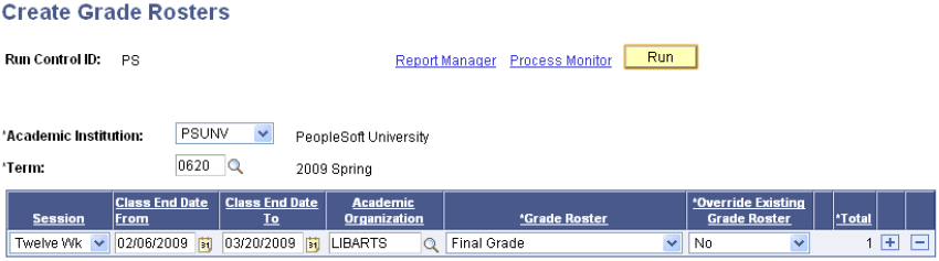

  • Create grade rosters for a single class.
  • Create grade rosters for multiple classes.

  5. Generate grade rosters on either the Grade Roster Type page or the Create Grade Rosters page.
RUNCTL_GRD_ROSTER
Curriculum Management, and then Grading, and then Create Grade Rosters, and then Create Grade Rosters
Create grade rosters for each term and session by subject area or by academic organization. To print the grade rosters, use the Grade Roster Print page. If you want to use blind grading for this class, select the Use Blind Grading check box on the Class Associations page or select the Use Blind Grading check box on the Course Catalog Offerings page so that the system uses blind grading each time that you schedule the class. The system then populates the Use Blind Grading check box each time that you create a class association.

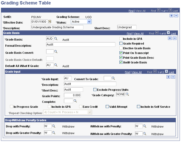

Defining Grading Schemes
Access the Grading Scheme Table page (Set Up SACR, and then Foundation Tables, and then Academic Structure, and then Grading Scheme Table, and then Grading Scheme Table).
This example illustrates the fields and controls on the Grading Scheme Table page. You can find definitions for the fields and controls later on this page.
Grading schemes are linked to academic careers and academic programs.
Field or Control Description
Status
Enter a status for this grading scheme. Enter Active when adding a new grading scheme. Enter Inactive only if your institution no longer uses this grading scheme.
Description
Enter a description for the grading scheme.
Short Desc (short description)
Enter a short description for the grading scheme.
Grade Basis
Enter a grade basis. Grade basis values are entered into your system as translate values, which you can modify.
A Grade Basis of NON (Non-Graded) is required for each grading scheme. This value is assigned for non-graded sections, such as labs associated with a lecture. To activate this grading basis, do not select any of the check boxes and do not enter any grades.
Formal Description
Enter a formal description of the grading basis.
Grade Basis Convert
Enter a grade basis convert value to use grades that are associated with another grading basis. If you enter a value in this field, the Grade Input group box becomes unavailable because the grade basis references the grade input data of another grade basis.
Grade Basis Choice Default
If you select the Elective Grade Basis check box, you can enter a grade basis choice default to specify the default grade basis for this grading scheme. In addition, you can enter all of the possible grading basis choices in the fields that become available in the bottom third of the page. The system uses the default value during enrollment. If students have the option to select other grade bases, they can do so at enrollment time.
Include in GPA (include in grade point average)
Select to include grades from this grading scheme in grade point average (GPA) calculations.
Grade Required
Select to specify this grade basis as required, for the purposes of the Grade Review - Transcript Release process. When you evaluate students using the Grade Review process, those classes in which the students are enrolled with a required grade basis must have all of their grades; otherwise, a transcript is not generated for the student.
Selecting this option can prevent transcripts from printing until all of a student's term grades are posted.
See Processing Batch Transcripts (Application Engine).
Select to enter the grading bases from which the student may select during enrollment.
Print on Transcript
Select to display, on the transcript, classes that are graded with this grade basis. If you do not select this option, all class data for courses that have grades that are from this grade basis do not appear on the transcript.
Print Grade Basis Desc (print grade basis description)
Select to have the formal description of the grade basis appear on the transcript.
Audit Grade Basis
Select to indicate that the grading scheme is audit-only. If you select this check box, the following check boxes in the Grade Input group box become unavailable: In Progress Grade, Include in GPA, and Earn Credit.
Grade Input
If you enter a grade basis and clear the Elective Grade Basis check box, or if you do not enter a value in the Grade Basis Convert field, the Grade Input field becomes available. Enter all of the valid grade values for the grading scheme in the Grade Input field. Add rows as necessary.
Convert To Grade
When you post grades, the system converts the originally entered grade to the convert to grade if a value exists in the Convert to Grade field. This field is optional. The convert to grade must be within the grading scheme that you are currently defining.
Description
Enter a description for the grade input.
Enter a short description for the grade input.
Exclude Progress Units
Select to have the system exclude this grade from progress units. For example, you would select this check box for a W or withdrawal grade.
Grade Points
Enter the grade points for the grade input. The system uses these grade points, in conjunction with the units attempted for the class, when it calculates GPA.
Complete
This field is user-defined. Define complete values on the Complete Grade Flag page. In New Zealand, this field is used for reporting purposes.
Grade Category
Use this field to give a grade additional identity. You can assign a grade category to a particular grade or a group of grades, and then use these assignments for advanced advising analysis purposes, such as requisite checking or academic advising limits. By default, the system populates the Grade Category field with None.
A typical example of a grade category is Pass or Transfer Pass. You can use academic advising to limit the number of classes with grade categories of Transfer Pass that count toward degree requirements. Select from a list of grade categories that are defined by your institution.
Grade categories are defined on the Grade Category Table page.
See Academic Advisement: Setting Up Grade Category Values.
In Progress Grade
Select to indicate that this is an in-progress type of grade. A typical example of an in-progress grade would be an incomplete grade.
Select to include the grade that you specify in GPA calculations. An example of when you would not select this check box is for a Pass grade.
Earn Credit
Select to specify that the grade can be counted toward course and academic advising credit.
Valid Attempt
Select to mark each grade value as representing a valid course attempt. PeopleSoft Academic Advisement uses this setting to distinguish between grades for valid course attempts (A, B, C, D, F, and so forth) and grades for invalid course attempts (AU, W, and so forth).
If you select this check box, Academic Advisement can distinguish between valid and invalid course attempts when the values in the Units Attempted, Earned Credit, and GPA fields are the same.
Include in Self Service
Select to enable the grade input value to be assigned and edited on the Faculty Center Grade roster. If you clear this check box, instructors cannot assign or edit this grade on the self-service grade roster. A typical example is to clear the check box for a W, an administrative withdrawal grade.
Repeat Checking Option
Select an option to indicate whether a class with this grade should be counted as a repeat candidate and whether the class should be processed by the Repeat Checking process. Values are:
  • 1) Count = Y Process = Y: If you select this option, any class with this grade is counted in the pool of repeat attempts and is selected and processed when the Repeat Checking process is run.
  • 2) Count = Y Process = N: If you select this option, any class with this grade is counted in the pool of repeat attempts, but is not selected and processed when the Repeat Checking process is run.
  • 3) Count = N Process = Y: If you select this option, any class with this grade is not counted in the pool of repeat attempts, but is selected and processed when the Repeat Checking process is run.
  • 4) Count = N Process = N: If you select this option, any class with this grade is not counted in the pool of repeat attempts, nor is it selected and processed when the Repeat Checking process is run.

Drop/Withdraw Penalty Grades
When processing drops during the penalty periods, the enrollment engine uses the penalty grades specific to the student's grading basis, as defined on the Grading Scheme Table page. If you do not define penalty grades for the student's grading basis, the enrollment engine instead uses the grading bases and grades that you define on the Session Calendar1 page (for withdraw grades) and the Session Calendar 2 page (for drop grades). We strongly suggest that you define penalty grades at the grade basis level to ensure that students receive penalty grades specific to their intended grade basis for the class, and not the penalty grade that is assigned to all students in the session, regardless of whether the penalty grade is from the student's original grade basis.
For example, when you drop a student from a class for which the stdnt_enrl.grading_basis_enrl = AUD during Drop With Greater Penalty and a drop with greater penalty grade exists in the GRADE_TBL for AUD, the system assigns the drop with greater penalty grade to the student. If no drop with greater penalty grade exists at the grade table level for an AUD grade basis, the system instead uses the grading basis and grade from the ACAD_CALSES_TBL, as defined on the Session Calendar2 page.
See Campus Solutions Application Fundamentals: Setting Up Session Cancellation and Withdrawal Dates.
See Campus Solutions Application Fundamentals: Setting Up Session Drop Dates.
Drop with Penalty
Enter the penalty grade that students who are enrolled with this grade basis receive for a class if they drop the class after the drop-and-retain-record deadline but on or before the drop-with-penalty deadline. The grade for the class appears on students' transcripts and affect their GPA accordingly. Grade values are defined on the Grading Scheme Table page.
Drop with Greater Penalty
Enter the grade that students who are enrolled with this grade basis receive for a class if they drop the class after the drop-with-penalty deadline but on or before the drop-with-greater-penalty deadline. The grade for the class appears on students' transcripts and affect their GPA accordingly. Grade values are defined on the Grading Scheme Table page.
Withdraw with Penalty
Enter the grade that students who are enrolled with this grade basis receive for a class if they withdraw after the withdraw-without-penalty deadline but on or before the withdraw-with-penalty deadline. The grade for the class appears on students' transcripts and affect their GPA accordingly. Grade values are defined on the Grading Scheme Table page.
Withdraw with Greater Penalty
Enter the grade that students who are enrolled with this grade basis receive for a class if they withdraw after the withdraw-with-penalty deadline but on or before the withdraw-with-greater penalty deadline. The grade for the class appears on students' transcripts and affect their GPA accordingly. Grade values are defined on the Grading Scheme Table page.

Access the Create Grade Rosters page (Curriculum Management, and then Grading, and then Create Grade Rosters).
This example illustrates the fields and controls on the Create Grade Rosters. You can find definitions for the fields and controls later on this page.
Academic Institution
Enter the academic institution for the grade roster process. This value controls the type of data that is available in the remaining fields.
Term
Enter the term for the grade roster. Term values are defined on the Term Table page.
Session
Enter the session for the grade roster. The session value is optional. Use it to limit your roster production to a single session within the specified term. Session values are defined on the Session Table page.
Class End Date From and Class End Date To
Select the class end date from and to dates. The system selects rosters to create for classes with an end date that is greater than or equal to the value in the Class End Date From field and less than or equal to the value in the Class End Date To field. Both fields are optional and one may be entered without the other.
Academic Organization and Subject Area
Enter the academic organization or subject area for which to produce the rosters. You can enter the academic organization or subject area, but not both. If you enter an academic organization, the Subject Area field is unavailable for entry. Conversely, if you enter a subject area, the Academic Organization field is unavailable for entry. Academic organization values are defined on the Academic Organization Table page. Subject area values are defined on the Academic Subject Table page.
Grade Roster
Enter the type of grade roster that you want to generate. Grade roster values are delivered with your system as translate values. While you should not change the Final Grade value, you can add as many nonfinal grade values as you want.
Override Existing Grade Roster
Available values are:
Yes: Enter to delete and override any preexisting grade rosters when you run the Create Grade Roster process, regardless of whether you selected the Override Grade Roster check box on the Grade Roster Type page.
No: Enter to retain all prior grade rosters when you run the Create Grade Roster process, regardless of whether you selected the Override Grade Roster check box on the Grade Roster Type page. The system produces rosters only for those classes for which rosters have not yet been generated and appends any currently enrolled students who are not on the original roster.
Total
If you selected a grade roster type of MidTerm, this field becomes available. The system enables you to create as many rosters as you need for each class, as long as it is not a Final Grade roster type. Enter the total number of non-final grade rosters that are needed for each class in the Total field.
Run the PSJob SRPCGPR. Results of the Create Grade Rosters process appear on the Grade Roster page.
