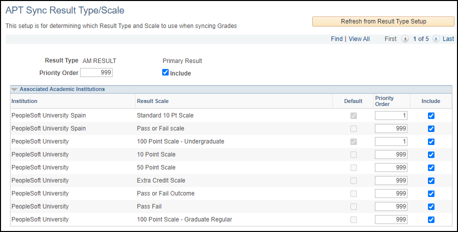

APT Sync Result Type/Scale Page
Use the APT Sync Result Type/Scale page (SSR_APT_SYN_RSLT) to prioritize and include the valid Result Types and Result Scales to sync grades to APT.
Navigation:
Records and Enrollment, and then Program Enrollment, and then APT Sync, and then APT Sync Result Type/Scale
This example illustrates the fields and controls on the APT Sync Result Type/Scale page.
APT Sync Result Type Scale page
Field or Control Description
Refresh from Result Type Setup
Click this button to retrieve the result types that are set up on the Result Type page. See Setting Up Result Types.
Note: The Result Types from the Result Type page with a Result Value Field Type of Result Scale and an Item Type Usage of Course are retrieved here.
Priority Order
Enter the order in which the Result Type is chosen to sync grades in APT Sync process. You must define the values before running the APT Sync Process.
Include
Select this check box to include the Result Type in APT Sync process. This check box is selected by default.
Associated Academic Institutions
Default
Displays the default Result Scales as defined in Result Type Setup. See Setting Up Result Types.
Priority Order
Determines the order in which the Result Scale is chosen to sync grades in APT Sync process within the Result Type. Users must define the values before running the APT Sync Process.
Include
Select this check box to include the Result Scale in APT Sync process. This check box is selected by default.

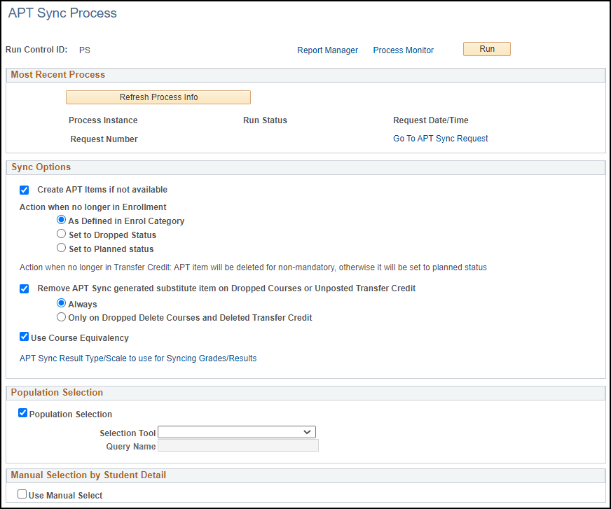

APT Sync Process Page
Use the APT Sync Process page (SSR_APT_SYN_RUNCNT) to synchronize the enrollment and transfer credit transactions to students APT.
Navigation:
Records and Enrollment, and then Program Enrollment, and then APT Sync, and then APT Sync Process
This example illustrates the fields and controls on the APT Sync Process page.
Most Recent Process
Refresh Process Info
Click this button to retrieve the most recent process information for the Run Control ID.
Go To APT Sync Request (go to academic progress tracker sync request)
Click this to open the APT Sync Request page which displays the most recent process request information.
Sync Options
Create APT Items if not available (create academic progress tracker items if not available)
Select this option to generate an APT Item sequence when an enrollment or posted transfer credit course matches AIR course and the planning node for the term has been created but there is no APT Item sequence yet.
Action when no longer in enrollment
Select the option you want to use if an enrolled course is drop deleted:
  • As defined in Enrol category: If the Enrollment Category assigned to the Course Item allows Add/Remove from APT, the enrollment is removed. If it is not allowed, the Course Item is set to Dropped status.
  • Set to Dropped Status: Course Item is set to Dropped status.
  • Set to Planned Status: Course Item link is deleted and set to Planned status.
Note: Action When No Longer in Transfer Credit APT Items are deleted for non-mandatory Courses. Mandatory Courses are set to Planned status. The process deletes an APT Item if there is only one attempt. If an APT Item has multiple attempts, only the attempt that matches the Term is deleted.
Remove APT Sync generated substitute item on Dropped Courses or Unposted Transfer Credit
Select when you want the process to delete a substitute item that was created through APT Sync:
  • Always: Remove item regardless if it is dropped only or drop deleted or unposted or deleted transfer credit.
  • Only on Dropped Delete Courses and Deleted Transfer Credit: Remove item only for dropped delete enrollment and deleted transfer credit.
Note: Substitute Items created manually in the APT page can't be deleted using this option. The substitution remains, and the status is set to Planned.
Use Course Equivalency
Select to match by Course Equivalency and generate substitution if the enrolled or transfer credit course does not find the match in AIR/APT.
Note: If the equivalent AIR course belongs to a course group, substitution isn't allowed.
APT Sync Result Type/Scale to use for Syncing Grades/Results (academic progress trackers sync result type/scale to use for syncing grades/results)
Click this link to open the APT Sync Result Type/Scale Setup page.
Population Selection
There are 5 delivered queries for this feature:
  • APT Sync by Course (SSR_APT_SYNC_BY _COURSE)
  • APT Sync by Program (SSR_APT_SYNC_BY _PROGRAM)
  • APT Sync by Student (SSR_APT_SYNC_BY _STUDENT)
  • APT Sync by Term (SSR_APT_SYNC_BY _TERM)
  • APT Sync by Term Sessions Course (SSR_APT_SYNC_BY _TERM_SESSION)
Include Multiple APT (include multiple academic progress trackers)
Select to enable picking courses from multiple APT instances.
Include Previously Unmatched
Select to attempt to sync students that were previously unmatched.
Manual Selection by Student Detail
Use Manual Select
Select this check box to manually select students for APT Sync.
Note: When using manual selection, the data automatically populates. For example, if you select a student who only has one enrollment to sync, you only have to select the Student ID and the other fields are automatically populated. If the student has two courses to sync, the only other prompt you have to provide will be which course you want to sync.
