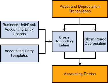

This diagram shows the processes for creating accounting entries:
This diagram shows the processes for creating accounting entries.
Processes for creating accounting entries
