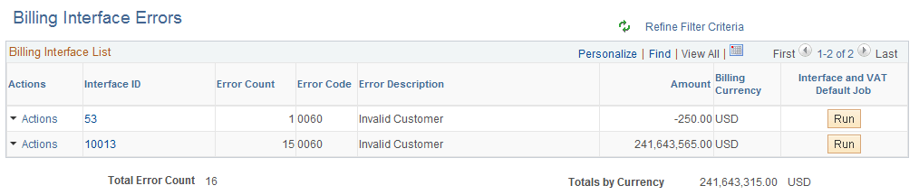

In Billing, the result of clicking a My Work system-defined link appears in an application grid that is tailored to the type of data being displayed. Billing uses two types of application grids, one for Invoices and one for Interface transactions.
The fields in the grid may vary by the link selected.
Click any of the options in Current Work to view the page in the transaction area. Users can select an option and perform any of the actions that are displayed. The action options available may change depending on what is selected on the left.
