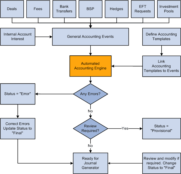

The following diagram illustrates the process flow:
Process flow for treasury accounting from general accounting event to Journal Generator
