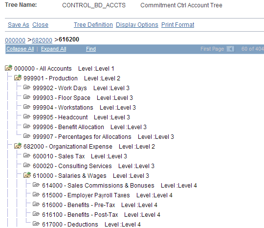

Accounts Tree Example
The following example illustrates how tree levels translate data.
Sample Translation Tree
Sample translation tree
The sample translation tree contains the following levels, beginning with the level 1 node:
  • Level 1: Node 000000
  • Level 2: 999901 and 682000
  • Level 3: 999902−999907, 600010−600020, 610000, and 616200−621000
  • Level 4: 614000−617000
When you define a control budget definition, you enter the tree level at which you want to define budgets for each key ChartField. Suppose that you want to budget at account ChartField level 3 for the sample translation tree. You enter tree level 3 for account on the Keys and Translations page. All account values found at level 3 and levels 2 and 1 above it are then valid for budget journals, and all source transaction account values below level 3 roll up for budget checking to the budgets that you define at that level. Budget Journal processing validates against the translation rules that you established in your budget definition in the tree to ensure that you selected the correct value for the budget account.
On the Control ChartField page, you can also choose whether to include all control ChartField values at your budgeting level or to exclude some. These are the results that depend on your choices:
  • If you select the All Values option, then all control ChartField values at or above the tree level that you entered on the Keys and Translations page are valid for budgeting and budget-checking.
    Source transactions with any value for the control ChartField are budget checked.
  • If you deselect the All Values check box, you must enter each value that you want to be valid for budgeting on the ChartField Values grid.
    Only source transactions with values that translate to the values in the list are budget checked.
For example, assume that you are budgeting at level 3. You deselect the All Values check box and enter the values 999901 and 610000 onto the ChartField Values grid. The following results occur:
  • If a purchase order has the level-4 account 614000, then the Budget Processor translates the account to 610000 by using the tree and level information that you entered on the Keys and Translations page.
    The Budget Processor checks account 610000.
  • If a second purchase order has the level-3 account 616200, the Budget Processor translates the account to itself.
    Because 616200 is not one of the level-3 accounts that you entered as valid for budget checking, the Budget Processor does not budget check this transaction.

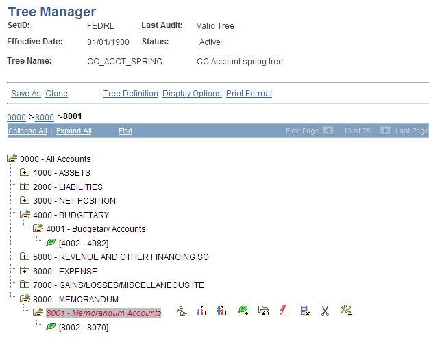

Winter Trees and Spring Trees
Commitment Control can use either winter trees or spring trees to translate budget keys.
A winter tree uses the detail value table for nodes and has no leaves. That is, each node is a valid detail ChartField value. The previous section, Accounts Tree Example, shows a winter tree.
A spring tree is a hybrid between a node-only winter tree and a summer tree. A summer tree uses the PS_TREE_NODE table for nodes and a detail value table for leaves. A spring tree uses a detail value table for the nodes as well as the leaves:
Spring Tree
Spring Tree
In this spring tree, the 4001 account is a budget-level node, whereas accounts 4002 - 4982 are detail-level leaves that roll up to the 4001 node. Note that you can define leaves in spring trees as ranges of detail values.
Spring trees reduce tree maintenance by allowing you to add ChartField values to the system without having to update trees, as long as new values are within a detail-value range already defined for the tree.
Whether you use spring or winter trees, each node must be a valid ChartField value. You must therefore assign the detail table name as the tree node table in the tree structure.
