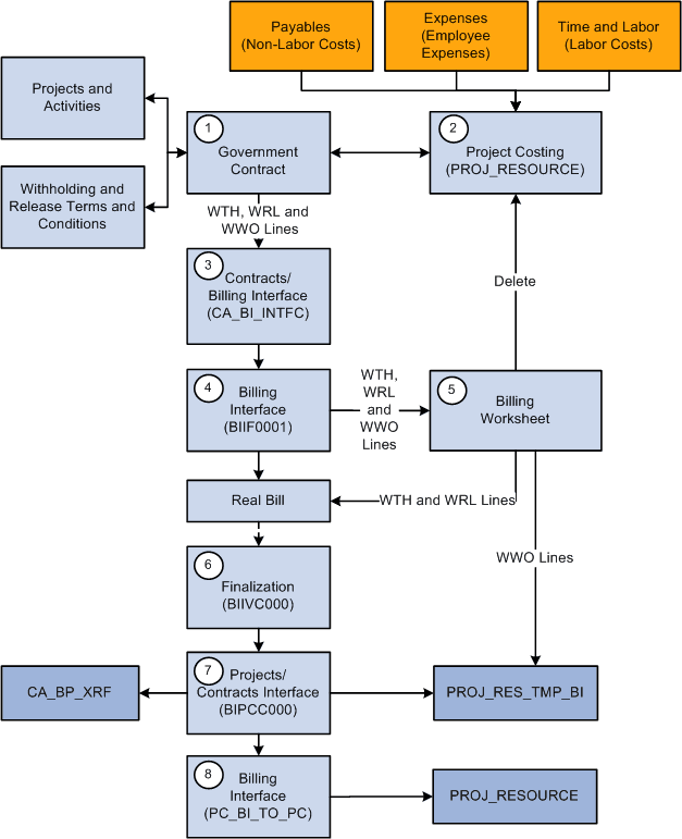

This process flow diagram illustrates the process flow associated with generating withholding and release billing.
Contracts withholding billing process flow
The following steps describe the Contracts withholding and release billing process flow:
  1. Before you can process withholding and release transactions, you must define withholding and release terms and conditions.
    The projects and activities that you associate with your contract lines are used to identify the transactions that the system uses to calculate the inception to date costs. Inception to date costs are the basis for calculating withholding amounts.
  2. The system calculates withholding amounts using the most current transaction data that is stored in the Project Transaction (PROJ_RESOURCE) table in PeopleSoft Project Costing.
    This includes cost transactions associated with the projects and activities linked to the withholding applicable contract line, and any previously processed withholding and release rows.
    To ensure that the withholding calculation process properly calculates the previous amounts withheld, it is important that you run the processes identified in this process flow diagram in the sequence indicated. Running the processes sequentially enables the system to update the Project Transactions tables with the processed withholding-related transaction rows before the next instance of the withholding calculations are run.
  3. Run the Contracts/Billing Interface (CA_BI_INTFC) process to calculate withholding amounts and process release amounts.
    This process selects only billing rows for contract lines associated to an as-incurred billing plan that is in Ready status. Release rows must also be in Ready status to be processed.
    The Contracts/Billing Interface process performs the following tasks:
    • Examines the eligible transactions and calculates the ITD costs.
    • Calculates withholding amounts according to the withholding terms and conditions.
    • Performs currency conversion to convert any foreign transaction amounts to the contract currency.
    • Generates and inserts withholding (WTH), withholding release (WRL), and withholding write-off (WWO) rows and associated accounting distribution data into the Billing Interface Staging tables (PS_INTFC_BI).
  4. The Billing Interface (BIIF0001) process passes the billable data to PeopleSoft Billing.
    If the Pre-Approved check box on the billing plan is deselected, the billing interface process creates a temporary bill containing the withholding, withholding release and withholding write-off transaction rows to be approved or deleted using the billing worksheet.
    If the Pre-Approved check box is selected on the billing plan, the Billing Interface creates a permanent bill containing the withholding and withholding release rows and passes the withholding write-off transaction rows to the Project Costing Project Resource Temporary Billing table (PROJ_RES_TMP_BI) to then be sent back to PeopleSoft Project Costing.
    The Billing Interface process performs the following tasks:
    • Populates the Bill Header record with a temporary bill, to be approved or deleted using the Billing Worksheet page.
    • Populates the Bill Line record with the withholding (WTH), withholding release (WRL) and withholding write-off rows.
    • Populates the Bill Line Distribution Detail with the Contract Asset distribution data from the accounting rules.
  5. Approve or delete billable rows, withholding (WTH), withholding release (WRL), and withholding write-off (WWO) rows using the billing worksheet.
    Write-off rows are passed to the Project Resource Temporary table (PS_PROJ_RES_TMP_BI) with the analysis type of WWO and a PC_DISTRIB_STATUS of N (Not Distributed). Billing data that is approved is copied to a permanent bill in PeopleSoft Billing, assigned an invoice number, and updated to a RDY (Ready) status.
    If you delete the withholding and release transactions from the billing worksheet, the system cancels the withholding rows and updates PeopleSoft Contracts and PeopleSoft Project Costing to reset the transaction statuses so that the withholding and release transactions can be processed the next time that the Contracts/Billing Interface process is run.
  6. The billing finalization process (BIIVC001) performs a variety of tasks including, generating the invoice, including any summarized withholding bill lines on the invoice, setting the invoice date, calculating a due date, and updating the invoice status to INV (Invoiced).
  7. After the invoice is finalized, you must run the Projects/Contracts Interface process (BIPCC000) .
    This process performs the following tasks:
    • Updates the Project Resource Temporary tables (PS_PROJ_RES_TMP_BI) with withholding (WTH) and withholding release (WRL) rows, and a Billing Distribution Status (BI_DISTRIB_STATUS) of D (Distributed).
      If manual adjustments are made to withholding or withholding release rows in PeopleSoft Billing, the Projects/Contracts Interface process also passes withholding adjustment (WAJ) rows and withholding release adjustment (WRJ) rows to the Project Resource Temporary tables to be passed to PeopleSoft Project Costing.
    • Updates the release status in the Contract Line Releases table to Complete for invoiced withholding release (WRL) bill lines.
    • Updates the Contracts Billing Cross Reference table (CA_BP_XREF) for the contract line billing plan with summarized bill data.
  8. Run the Billing to Projects process (PC_BI_TO_PC) to update the Project Costing Project Transaction table (PROJ_RSOURCE) with the billed, withholding (WTH), withholding release (WRL), withholding write-off (WWO) rows, and billing distribution statuses from the Project Resource Temporary tables (PS_PROJ_RES_TMP_BI).
    This data is used to calculate the withholding amounts and inception to date costs the next time that the withholding process is run.
    If manual adjustments are made to withholding or withholding release rows, the resulting adjustment (WAJ or WRJ) rows are also passed to the Project Transactions table.
