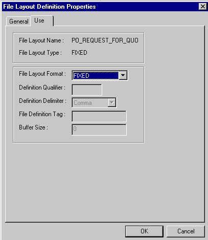

Reviewing the File Layout Definition Properties Dialog Box
The following is an example of a File Layout Definition Properties dialog box.
This example illustrates the fields and controls on the File Layout Definition Properties dialog box. You can find definitions for the fields and controls later on this page.
The EDI transaction's data record structure appears as follows:
XXXYAAABBBBB
where:
  • XXX is the three-character ECFILEROWID.
  • Y is the one-character AUDIT_ACTN flag.
  • AAABBBB.... are the fields.

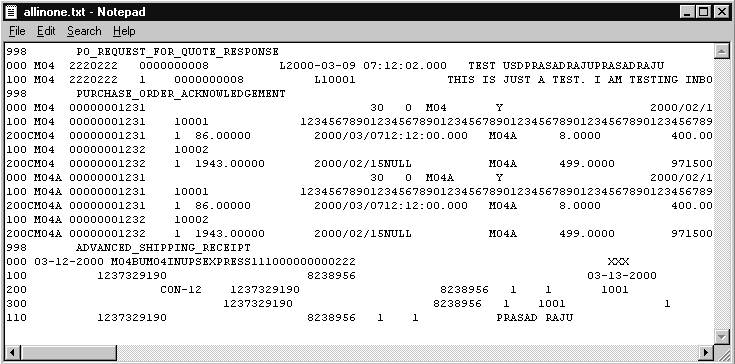

The following figure shows a sample file containing three distinct file definitions.
This example illustrates the fields and controls on the Sample file with distinct file definitions. You can find definitions for the fields and controls later on this page.
For this file definition example, consider the following:
  • The PO_REQUEST_FOR_QUOTE_RESPONSE control record has a single transaction.
  • The PURCHASE_ORDER_ACKNOWLEDGEMENT record has two transactions.
  • The ADVANCED_SHIPPING_RECEIPT has a single transaction.
