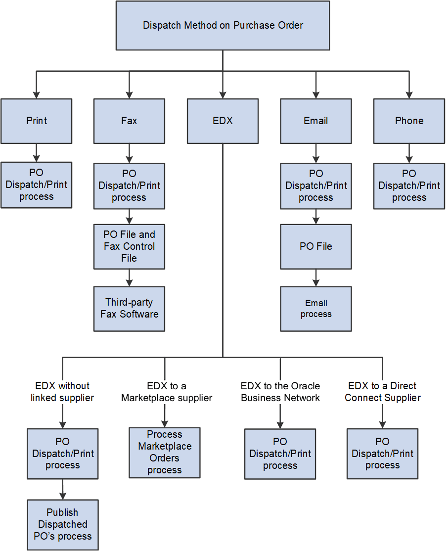

The following diagram illustrates the dispatch methods for PeopleSoft eProcurement, including print, fax, electronic data exchange (EDX), email, and phone.
This diagram illustrates the dispatch methods for PeopleSoft eProcurement.
Dispatching a purchase order in PeopleSoft eProcurement
