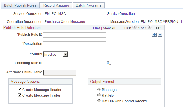

Batch Publish Rules Page
Use the Batch Publish Rules page (EO_MSGPUBATCH) to define batch publishing rules that determine how the dynamic dispatch transactions should be sent electronically.
Navigation:
Enterprise Components, and then Integration Definitions, and then Batch Publish Rules
This example illustrates the fields and controls on the Batch Publish Rules page.
Use this page to associate a rule to a message and characterize the rule.
Batch publish rules describe jobs or processes that run independently from their initiating process. A batch process can also run at one or more predetermined times in the future from the initiating request. This is appropriate for publishing incremental changes to data in a batch environment or when processing large volumes.

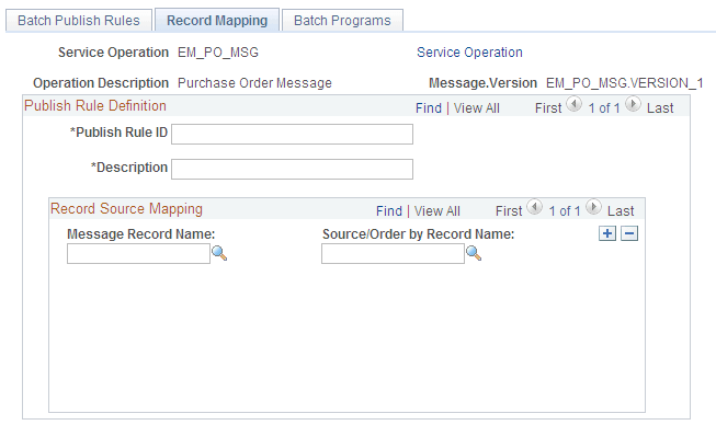

Record Mapping Page
Use the Record Mapping page (EO_MSGRECMAP) to specify source data for records (such as POs) in messages.
Navigation:
Enterprise Components, and then Integration Definitions, and then Batch Publish Rules, and then Record Mapping
This example illustrates the fields and controls on the Record Mapping page.
Record Mapping page
Use this page to map the Message Record Name to the Source/Order by Record Name.

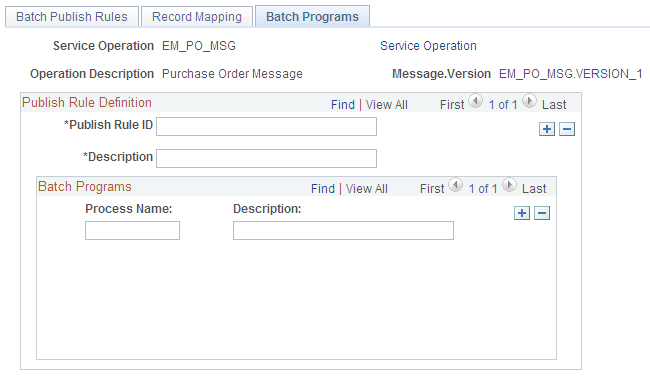

Batch Programs Page
Use the Batch Programs page (EO_MSGBATPGM) to associate publish processes with rules.
Navigation:
Enterprise Components, and then Integration Definitions, and then Batch Publish Rules, and then Batch Programs
This example illustrates the fields and controls on the Batch Programs page.
Batch Programs page
Use this page to assign an application program (PROCESS_NAME) to the publish rule.
