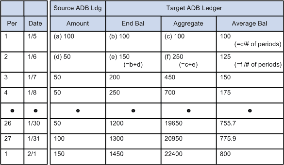

This table shows how the system calculates average daily balances for a date-to-date period type (DTD), starting January 5 through the request date of February 1. The ADB ledger uses a monthly calendar.
Calculation Using a DTD Period Type
This table shows incremental day-to-day calculations:
Incremental Day-to-Day ADB Calculations
Incremental day to day calculations
In this case, even though February 1 is in the next period, the system still uses the previous day's ending balance and aggregate amount in the calculation.
