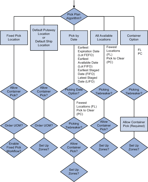

Picking Rule Hierarchy
No matter which algorithm you select, the Order Release Request process follows a basic picking rule hierarchy. The following diagram illustrates this hierarchical flow, along with the slight variations that each algorithm presents:
Picking rule hierarchy for the picking algorithms
