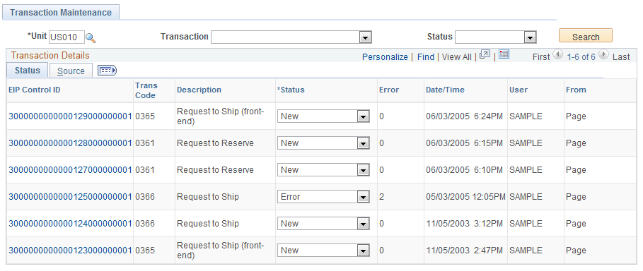

Transaction Maintenance Page
Use the Transaction Maintenance page (BCT_CTL_UPD) to view all electronic transactions in the transaction log and access the detail pages that enable you to correct transaction errors.
Navigation:
SCM Integrations, and then Transaction Error Handling, and then Maintain Transactions, and then Transaction Maintenance
This example illustrates the fields and controls on the Transaction Maintenance page. You can find definitions for the fields and controls later on this page.
The Transaction Maintenance page is used to access error-correction pages for transactional data. You can view, correct, and resubmit transactions on the Transaction Maintenance pages. For example, if an XML file is loaded with a blank Item ID field, that file generates an error. You can correct the errors and then resubmit the message from the Transaction Maintenance pages.
