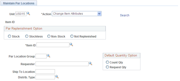

Use the Maintain Par Locations page (CART_MASS_MAINT) to modify header or item information for multiple par locations.
Navigation:
Inventory, and then Replenish Par Locations, and then Maintain Par Locations
This example illustrates the fields and controls on the Maintain Par Locations page. You can find definitions for the fields and controls later on this page.
The Maintain Par Locations page
To perform par location mass maintenance:
  1. Enter a business unit and select an update action: Add Item, Change Header Attributes, Change Item Attributes, Delete Item, or Replace Item.

  4. Select par locations to be updated.
    The grid at the bottom of the page displays the par locations that match the selection criteria. Select the check box next to each par location that you want to update. To update all of the par locations that appear, click Select All; to clear all selections, click Deselect All.
