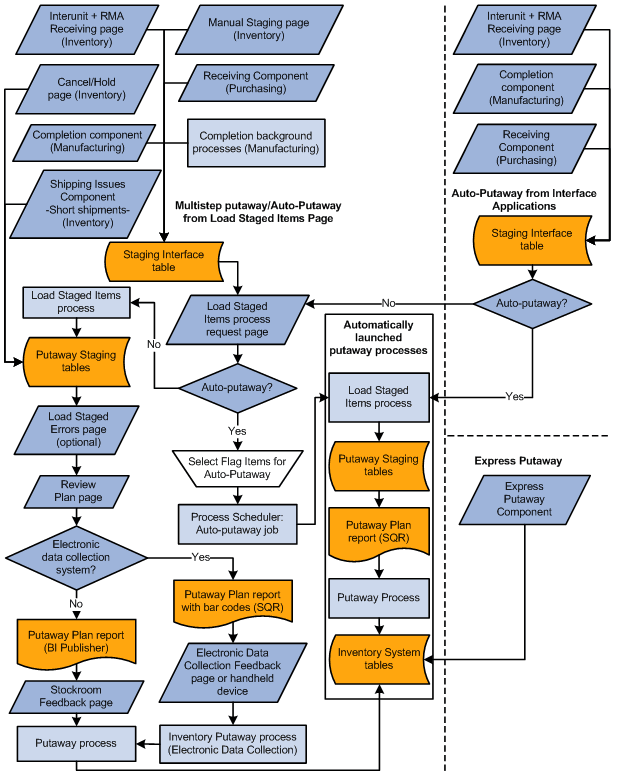

Putaway Process Flow
This diagram illustrates the level of control over putaway processes that is offered by the multistep putaway, auto-putaway, and express putaway methods:
The business process flow for the Putaway options
