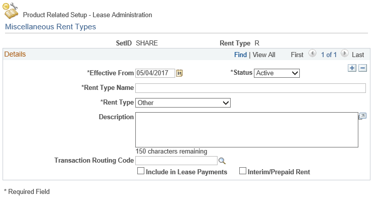

Miscellaneous Rent Types Page
Use the Miscellaneous Rent Types page (RE_MISC_FEES) to define miscellaneous rent types.
Navigation:
Set Up Financials/Supply Chain, and then Product Related, and then Lease Administration, and then Financial Terms, and then LA Miscellaneous Rent Types
This example illustrates the fields and controls on the Miscellaneous Rent Types page. You can find definitions for the fields and controls later on this page.
Field or Control Description
Rent Type
The available options are:
  • Initial Direct Cost: Payments that are initial direct cost or fees to third parties. Initial Direct Costs are included in the ROU Asset, but not in the lease liability.
  • Other:
Include in Lease Payments
Select to indicate whether the amount must be included in the ROU Asset and Lease payments or not.
If the Include in Lease Payments check box is selected for a miscellaneous rent type, then the payments generated from the lease financial term having that miscellaneous rent type are included in the capitalized lease amount.
Note: The check box is displayed only if the Rent Type option is Other.
Interim/Prepaid Rent
For an interim/prepaid rent payment schedule, interest expense is always zero and the entire rent amount will be the obligation reduction.
