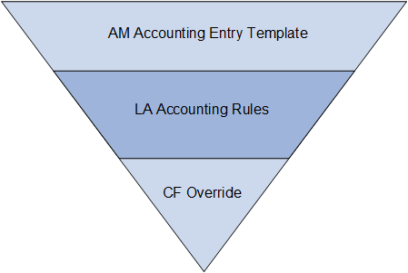

The lease accounting hierarchy provides flexible defaulting for lease payment-related accounting entries. The lease payment (LPY) and the prior period lease payment (PLP) accounting entry templates in Asset Management serve as the highest level of the lease payment accounting entry default hierarchy. The lease obligation (LO) can be overridden by the lowest level of Transaction Group/Routing code combination LA Accounting Rule, followed by ChartField Override at the lease term level.
The following graphic illustrates the PeopleSoft Lease Accounting Hierarchy.
Accounting Hierarchy is applicable only for payable leases.
For additional information, refer PeopleSoft Asset Management: Understanding Accounting Entry Setup
