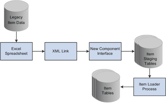

This diagram shows the process of loading item data from a spreadsheet. Each step is discussed following the diagram:
Master Item Load Component Interface process
This process is divided into five steps:
  1. Creating the spreadsheet.
  2. Using the XML link.
  3. Running the component interface.
  4. Reviewing the item staging tables.
  5. Running the Item Loader process.
