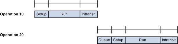

Example 1
This diagram shows an example of operations with no overlap and the queue and setup are done sequentially:
| Operation | Operation Start | Run Start | Operation Due |
10 |
Day 1, 8:00 a.m. |
Day 1, 9:00 a.m. |
Day 1, 2:00 p.m. |
20 |
Day 1, 5:00 p.m. |
Day 1, 8:00 p.m. |
Day 2, 6:00 a.m. |
