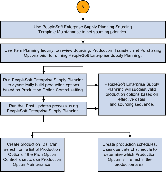

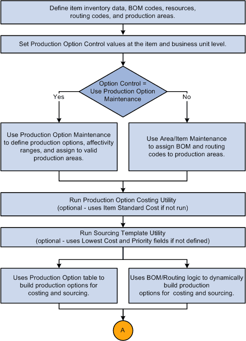

This flowchart provides a top-level view of how you can use production options:
This flowchart continues to provide a top-level view of how you can use production options:
